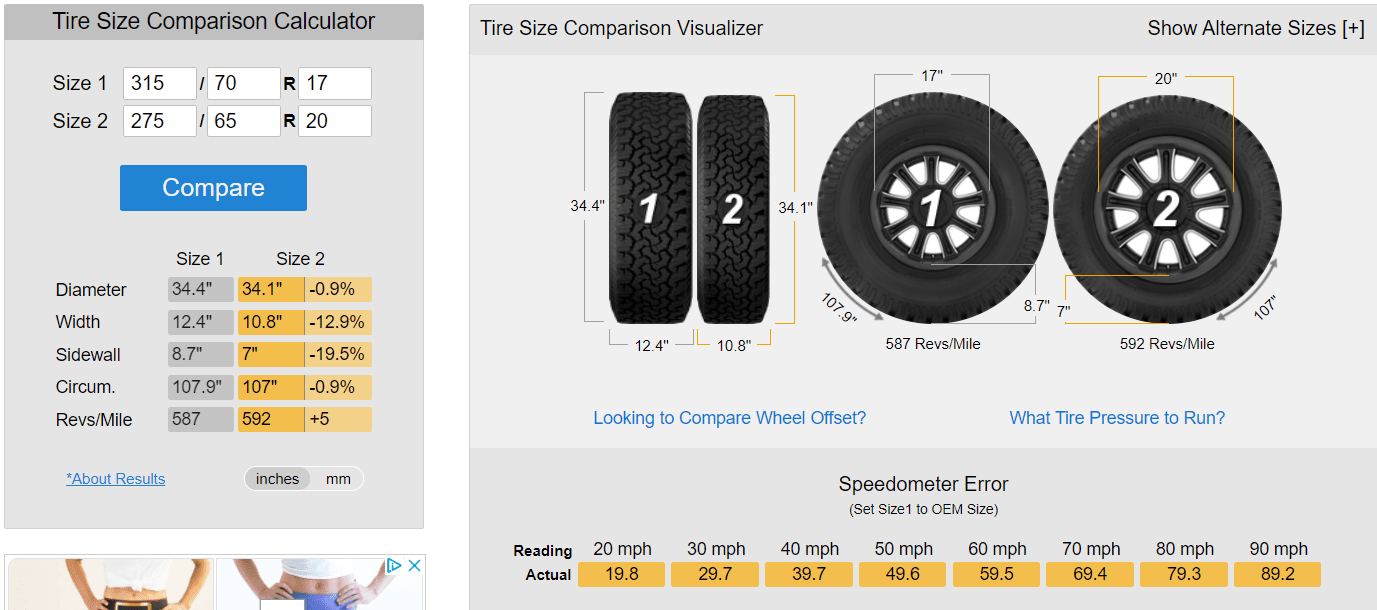

I feel like control is a bit better with the more skinny pizza cutter tires when driving in ruts of snow or slush on an unplowed road. I have run 315/70R17 (Hummer take-offs) in a couple different brands/patterns, but went to a 275/65R20 this time and like them much better in snow. Almost the same height, but significantly narrower footprint.
I still have the old ones for sand and trails in summer, but I didn't bother swapping this year. My truck doesn't get a lot of use in summer.
Can see the comparison here: (very handy site) https://tiresize.com/comparison/
