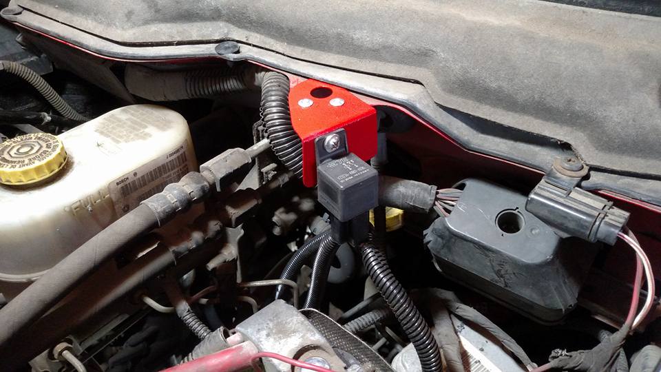

***Update*** Just installed the FASS Titanium system. Took me ~5 hours start to finish. I made my own bracket for mounting the relay on the flange just under the cabin filter. I'll try to post some pictures. Took a little more priming than I was expecting, but it finally fired up and ran smooth. Trying to decide what exactly to do with the OEM fuel line... Leave in place and cap, or remove??? Haven't taken it out on the road yet (wanting to finalize things with the OEM line first). Overall... I'm happy with the decision to go with FASS.
