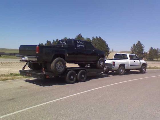

With 80-82 inch between the fenders a dually should fit with stock tires and the rear will be behind the fenders so no problem there. Here is a pic. on my 20', I was a little heavy on the hitch, I really needed a 22'.
