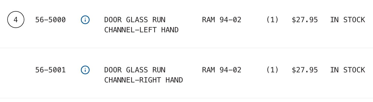

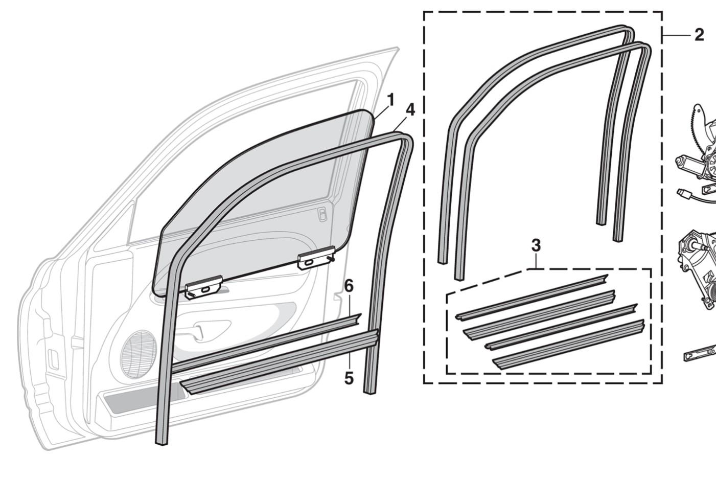

LMC Truck. In stock. The kit on the right, #2, is not available.
found em on LMC truck. Dread removing the door / window tracks...

If I’m not mistaken, you can roll the window down, pull the seal out at the top, then pull it up and out. Take the door panel off and push the new ones down in the track. An extra set of hands holding the window to one side while putting the first side in will help. Seems I remember spraying the track seals with WD-40, but again, I may be wrong.
