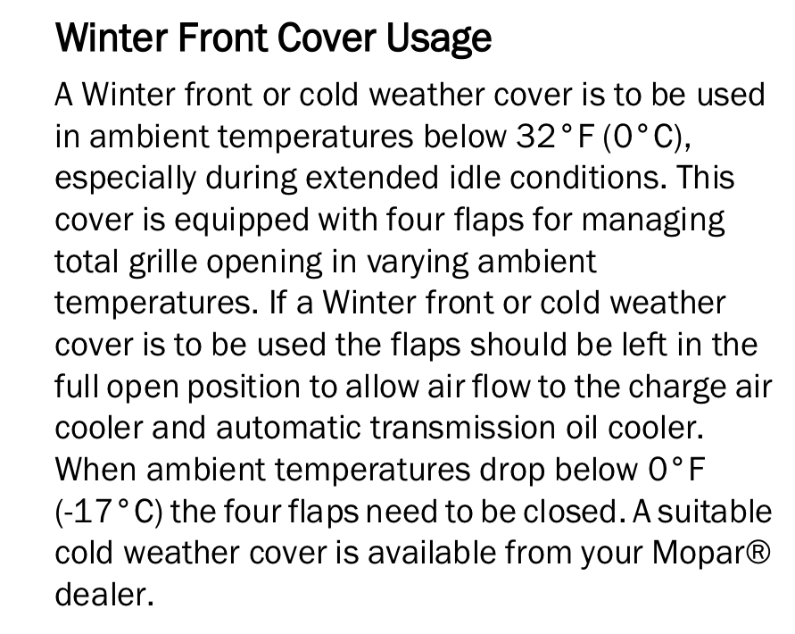

From the owners manual
It seems that they want that heat to be kept around the engine compartment for emissions purposes. Makes good sense if you would need to be at idle for extended times.
