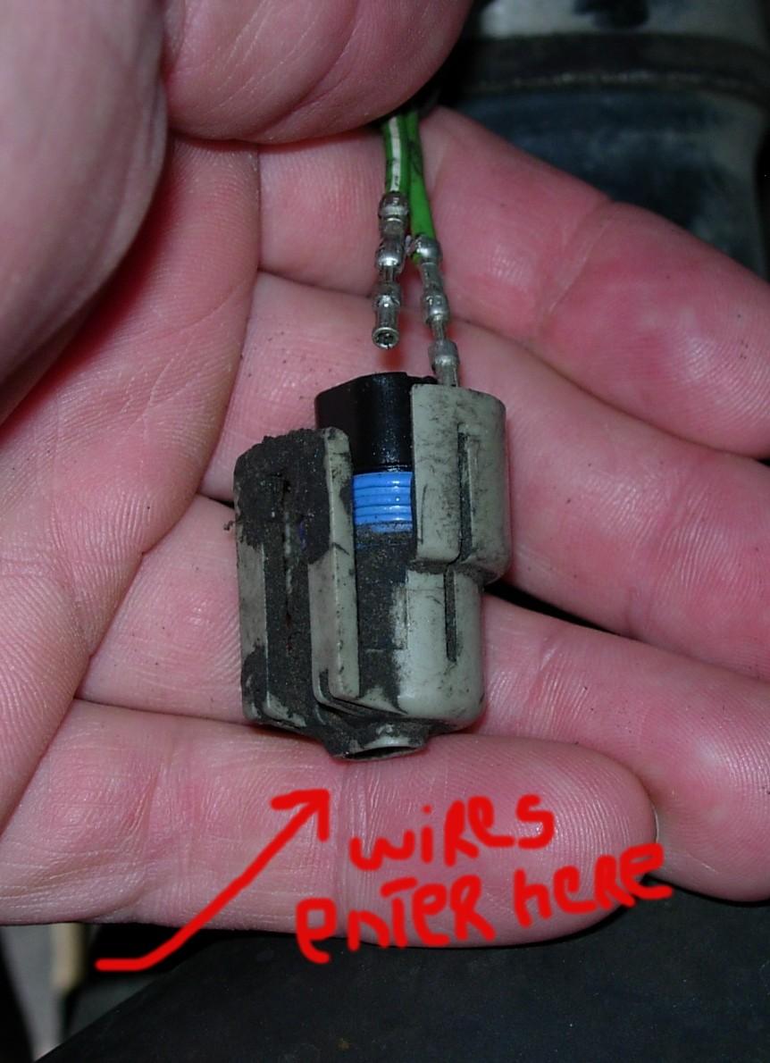

In the above pic, the connector in my hand is facing the wrong way. My apologies.

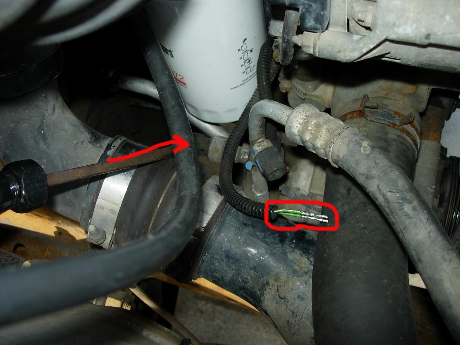

I don't remember how they popped out. It's been a few months. I'm pretty sure it was my fault...
On page 736 of the FSM, 8W-42-6, it shows my green wires, but I still don't know which side of the connector to use! A little help here would be greatly appreciated. If you know, please reference the connector with the locking tab facing up towards the sky! [similar to how it's laying in my hand]
If I install them backwards, will anything bad happen to the air conditioning system?

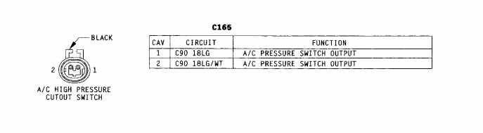

"The FSM also has pin out diagrams."
That got me thinking. Thinking led to page turning. 170 pages later... Bingo!
page 906, section 8W-80-34:
Thank you, Mr. Ames.
