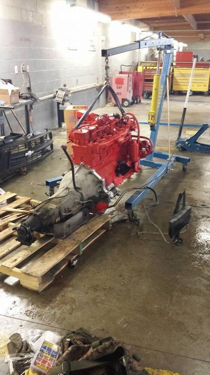

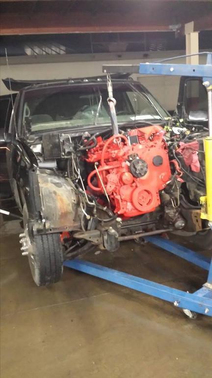

hello guys i have swapped a 1994 12v into my 1997 chevy 3500 and i am stuck on the wiring. there is so much and i dont know what to do. i have the diagrams but i cant read them
It shouldn't be that hard . Fuel shut off selenoid , tach wire , oil pressure, water temp . Just look at the diagrams like water pipes , go online and find the electrical symbols .

The tougher part will integrating gauges and Trans
You do not have to ditch your factory gauges. Everyone on 4btswaps still has theirs. All you do is get your sensors and put them on the cummins and for the transmission you use an external brain for it where you input the shift points.
