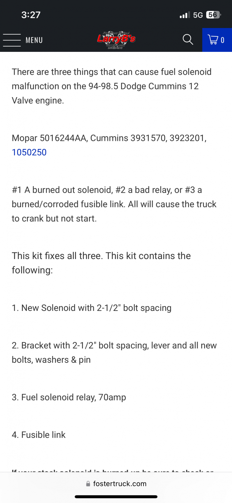

Before you buy anything look to see if the fuel shutoff solenoid (FSS) is functioning at all. Bump the starter and leave the key on then check to see if the FSS is up. Troubleshoot from there. I've owned my truck since new and have only had to replace the FSS once but I have used several relays and once repaired the blue fusible link.
