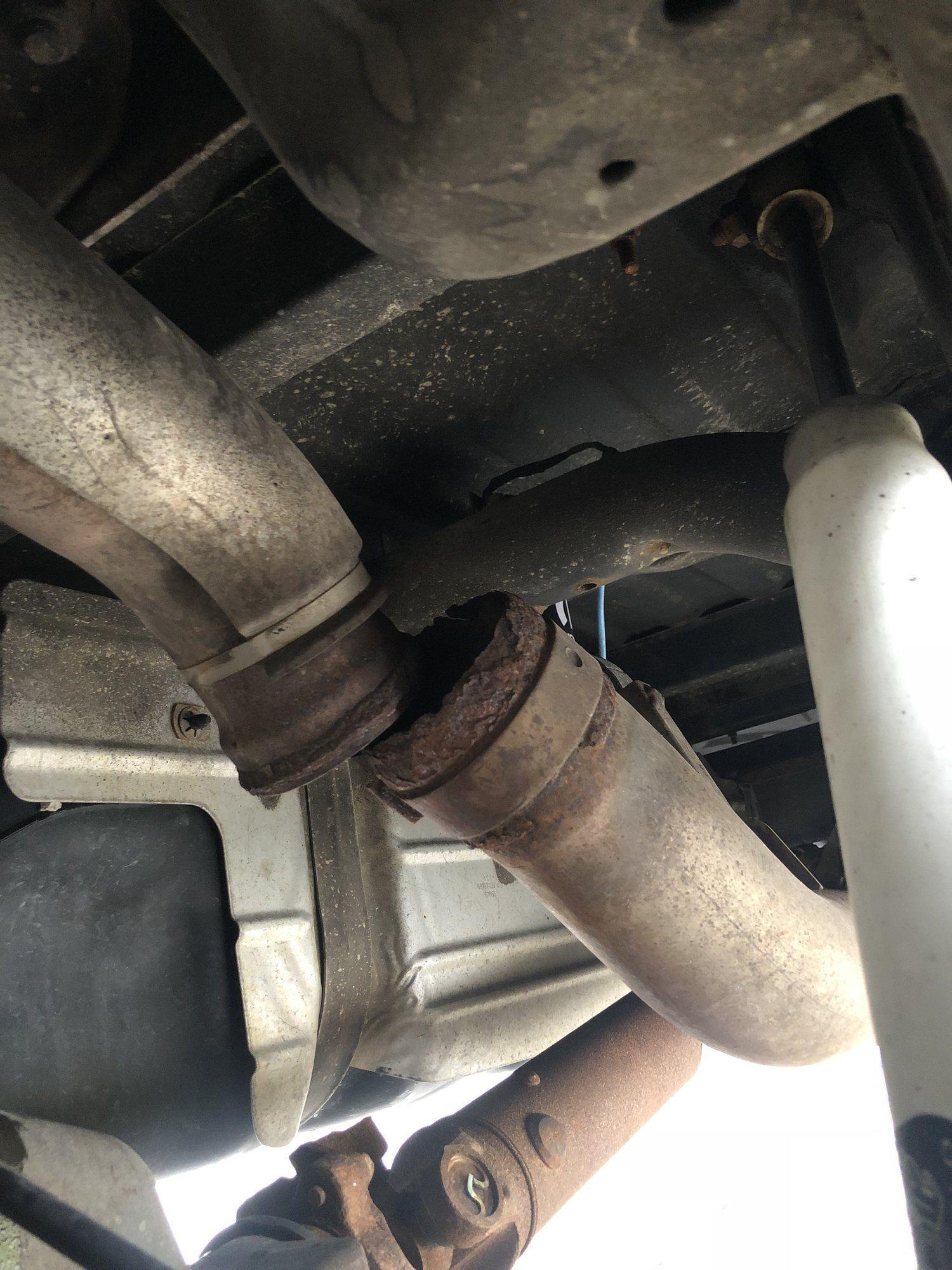

Pretty sad that the exhaust on a ‘14 only lasts 4 years. Even tho the price tag keeps rising, these trucks are becoming more and more pathetic as the years go on.
View attachment 109081 Pretty sad that the exhaust on a ‘14 only lasts 4 years. Even tho the price tag keeps rising, these trucks are becoming more and more pathetic as the years go on.
It's kinda hard to tell from the pic, but looks like (maybe) pipe slipped off ?? Some roadways I drive these days would shake the "Grin off Santa Clause"! Maybe you drive some of those roads, too...
LINEMan, its the chloride used on MN/WI roads.

Urea (Def) and ammonia that quickly combines with carbon dioxide and carbon monoxide in the exhaust (and) in the H2O (that is also a product of combustion and 68% of DEF) to form ammonium carbonate and ammonium carbomate is a corrosive concoction that eats away steel... Even more resistant alloys like stainless steel.
So the exhaust systems which are very complicated and expensive will need replaced more often than previous gens because they rot from both the inside and the outside as they are heated up. DEF and It's by products will rot it from the inside. Unlike previous truck systems.
Almost makes me wonder what they saw when they replaced my SCR catalytic converter a year and a half ago...... after 3 1/2 years of service (in terms of internal rot.)

Most automotive exhausts don't contain much more than 10-20% SS. Depending on grade the steel can be a mixture of carbon, nickel, aluminum, manganese, aNd chromium. 304 has been found to corrode fairly quick in scr equipped trucks due to urea decomposition and high temps. I don't know what is used on these trucks.
I've noticed my 14 rusting in that exact same spot. I thought it was strange considering the rest of the exhaust is clean. Looks like a closer inspection is in order!
I only see a round of rust at the DPF outlet. It looks like it is starting to corrode there (from the inside) like the above picture.
The joint to the tailpipe looks good at first look
It corroded form the outside due to the reaction of two different metals Pipe/Clamp when acidic liquids are heated with other liquids (Water)

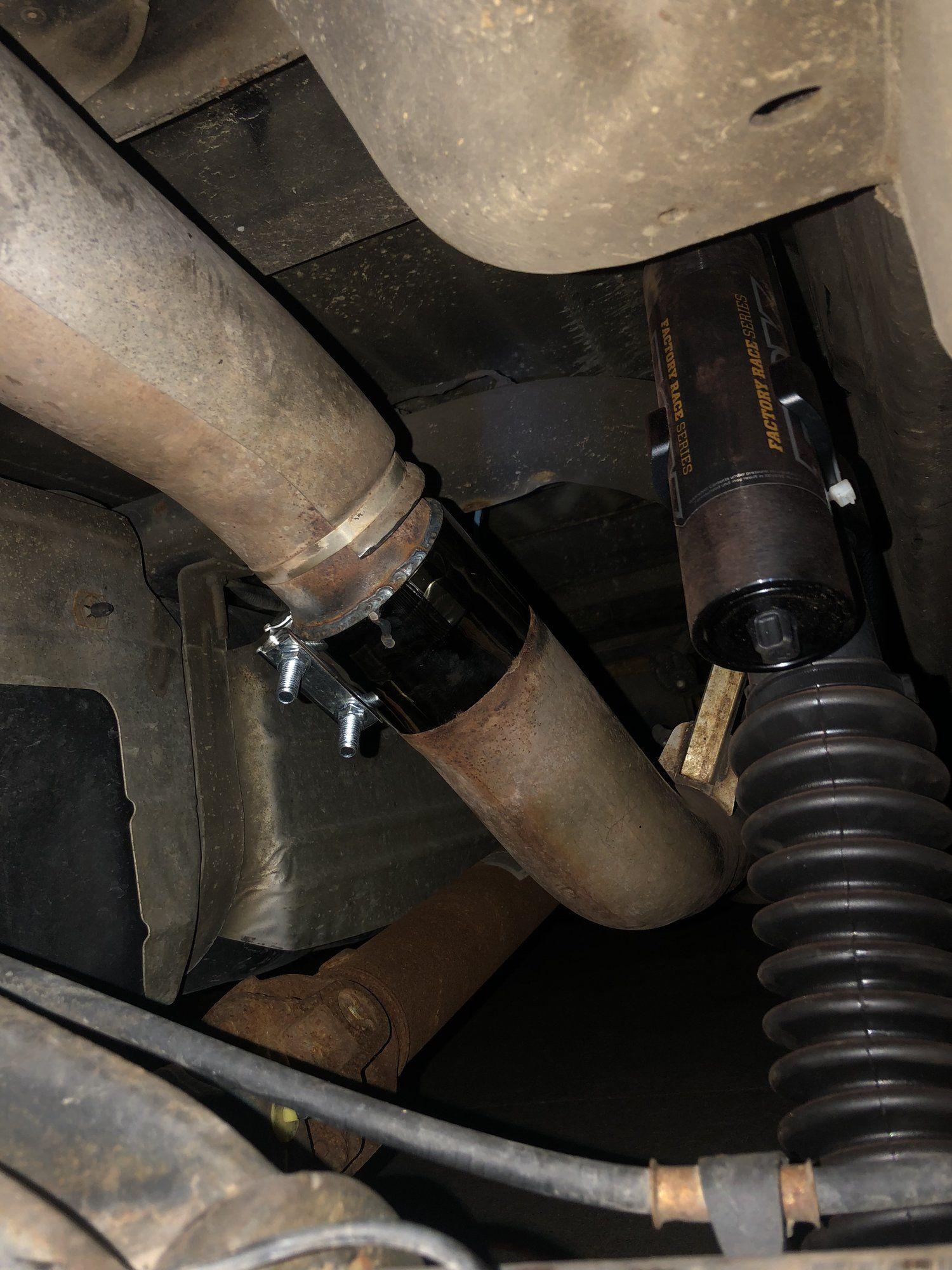

I didn’t even check. I cut all the corroded parts out and sanded it all clean. I welded a short piece of 4” pipe solid to the tail section of pipe. I then tacked it in 4 places to the forward pipe. I covered the joint with a 4” band clamp.
