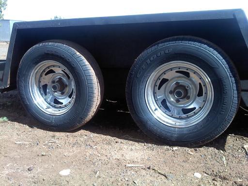

Has anyone ever dealt with this tire? They are made in Indonesia by PT. Elangperdana Tyre Industries but I can't find out anything on their trailer tires. A small local tire dealer just changed hands so I went to the open house and was impressed by the operation. So I asked the Lady in charge of ordering tires if she could get me a 205/75R14 in 8 ply ( I have only found one 14" tire in 8 ply....(Kenda Karrier) ... might be ok but located in Ohio. It took a while but she came up with a new tire from a trailer tire source that handle Zeetex.
It is a new tire in a new size, 205/75R14 = 195R14C, no aspect ratio but is like an 80 series, so I bought a set for my little car trailer, $88.00 each. They are 8 ply, rated 2094 lbs @ 65psi. They do not have the "ST" in the size and do not say "trailer use only". She told me they were rated for 112 mph, I was like "NOT" she said yes they are!! The side wall says ZEETEX CT1000, all season, 106/104s...2 ply poly, 2 steel and 2 nylon on the tread and 2 poly sidewall. The lady seemed well informed and said it is a new tire in a new size. They look really good.

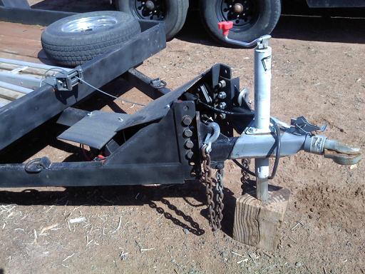

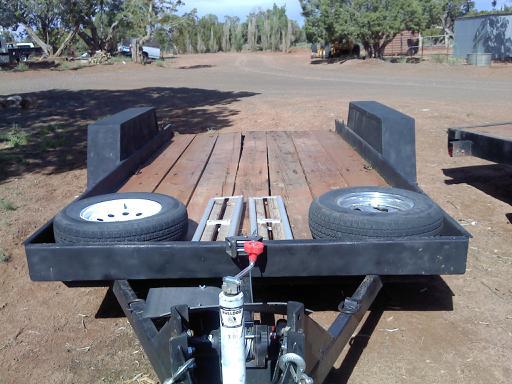

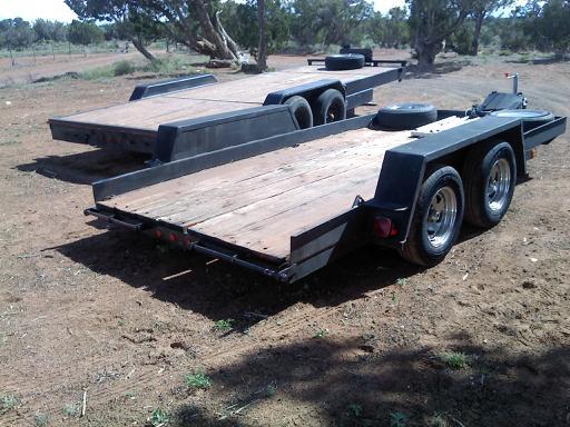

Here are some pictures of the trailer. It is a cool little 79"x14' 1991 Towmaster. Heavy duty little bugger, 3500lb axles rated 3'000, I think because of the L78x15 tires it come with from the factory. It has a 8730lb GVW, I think because of the heavy duty hitch. It was a commercial rental trailer with hydraulic surge brake hitch that was wore out and rusted beyond use. I replaced it with a Bulldog hitch, jack and electric brakes. New lights, small winch and now new tires. The mud flaps in the picture are covers for the winch and battery.

106/104s...
So, after a little more research the above numbers are the load index/speed rating. The 106 is the maximum load capacity at maximum air pressure or in this case 2094 lbs, but is not speed rated at maximum load. The 104s is a reduced load capacity of 1984 lbs and is speed rated to 112 mph.
If my understanding is correct, this might be an excellent tire for a 14" and could be a solution to buying 15" or 16" wheels and tires for a load capacity in the 3500 lb axle class. In my case I want to keep the trailer deck as low as possible to assist in loading small cars.
Can any of you tire guru's comment on this. Am I right or wrong in my understanding?

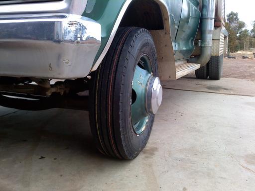

Yes, I will post back/update when I know more, I don't use that trailer much so it might be awhile. I like Hurcules tires, here is a pic of one on my steer axle on my Ford, 215/75Rx17.5, 16 ply.
