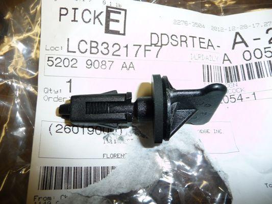

If you have not started the job, the only caution is that blankety blank radiator drain plug. Good advice might be to not touch it, siphon somehow. 2nd advice just turn it maybe just enough to start a trickle, don't turn it a bunch thinking that taking it out is a good idea, can lead to a lot of why did I do that syndrome. I have one of the only never been installed OE drain plugs on my shelf. At the time it took me like 6 months to get one as a backup.
If you're not careful with the plug, next post will be how do it get it to thread in?

Second gen rad plugs turn and screw out. Replace the o-ring and use silicone grease on it. Third gen have a flat rubber seal and they just thread out.
The problem that I and several others experienced was that the drain plug nut just turns endlessly if you unscrew the wing bolt out too far. If you can avoid this hassle, I think you'll have a better day.
