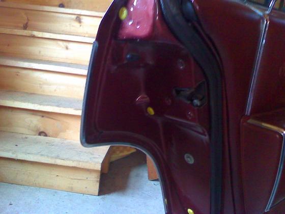

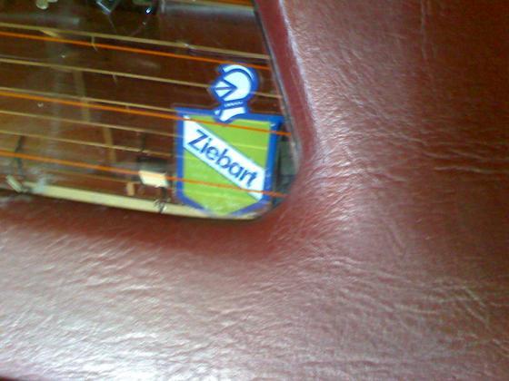

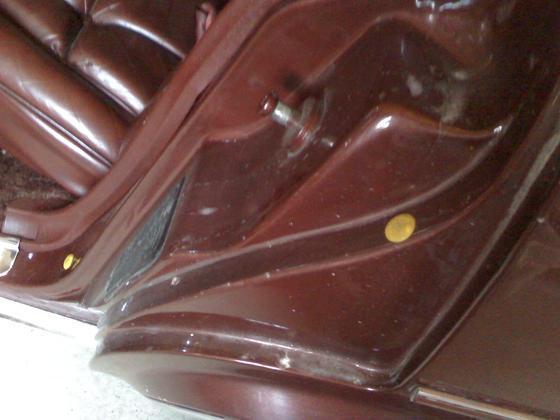

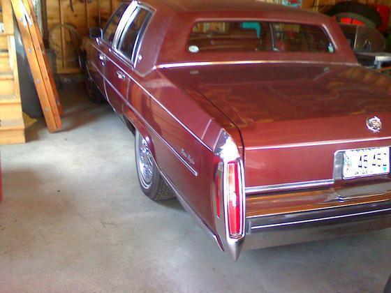

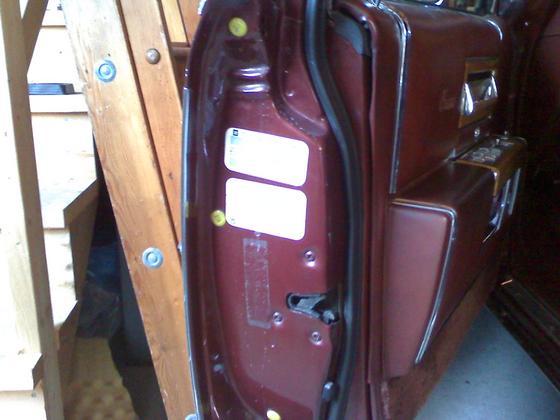

D4L,
Took these while I was retrieving the Mega Sunday before last... ... this car is full of Ziebart...
Mike.
