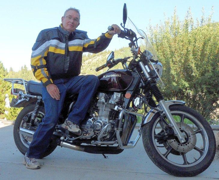

AH, been a number of things - lots fewer miles on the truck since moving up here to eastern Oregon, and fewer articles in the TDR mag related to my generation of trucks - plus, I took on a restoration of an old muscle bike from my earlier bike riding days:
That's an 1983 Kawasaki 1100 LTD, runs as good as it looks!
