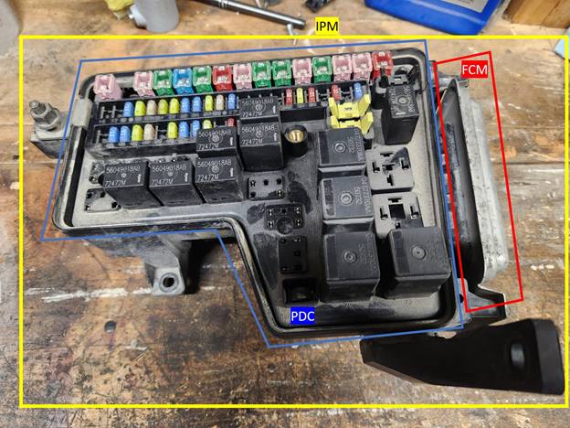

#1: 2nd vs. 3rd Gen part names: This probably isn’t news to most, I’m probably the slowest kid in class, but I thought the Integrated Power Module (IPM) was an add-on to the Power Distribution Center (PDC - what we used to call the fuse box) in 2nd Gen and earlier trucks. That isn’t the case. The IPM is the whole shooting match, the PDC and that silver thing on the side, which is actually the Front Control Module (FCM) I had referred to earlier in the post as the IPM. I also learned the code reader I bought a couple years ago to troubleshoot my kids’ Subarus will read the FCM in my tuck. Who knew? No codes from that silver box FCM, but here’s the picture showing it all.

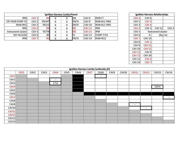

#3: Back to the basics. Topzide had given me a number of ideas and some links to check out, which clicked me into its time to kick in the old school Gen X. Time to dig in to the factory manual and do some real troubleshooting. Since I’m a cheap-a$$ I have the digital version of the manual, it took me about 13 billion clicks between wiring schematics to figure out what I need to test in the physical world. I’m sure most of you could have figured it out in about 5 minutes and 8 clicks, but like I said earlier, I’m not the sharpest knife in the drawer. Anyway, I built this chart to troubleshoot. Spoiler alert, the multimeter values are already filled in from troubleshooting.

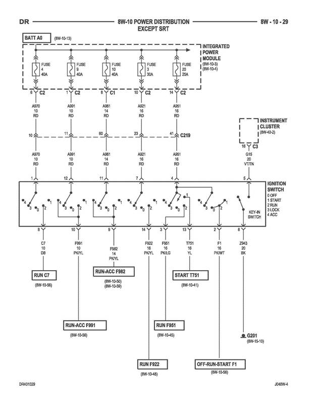

To me, this looks like the CAV 3 – 4 is the short. I was hoping it’s a short between the ignition harness and the IPM, but I’m done with hope. So I referenced the relevant wiring sheet from the factory manual.
Seeing that the CAV3 – 4 short corresponded to the IPM C2 harness, I pulled the C2 harness off, and now I have no shorts. Everyone is behaving. This leads me to believe the short is within the circuit board inside the IPM, either in the PDC or FMC. 20 years ago, I may have made the attempt to fix that. Now, not so much. I’ll just buy a new one, unless someone has a better idea? Maybe I’ve missed something?

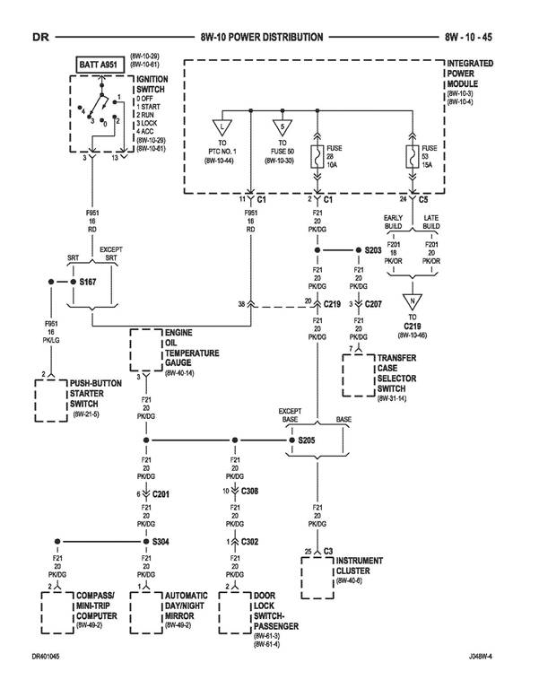

I also see I failed to include one critical schematic, showing that START F951 off of the ignition harness CAV3 only goes back to the IPM on C1, which is what ultimately led me to the decision to replace the IPM, not chase down other exterior wiring, so I’ve pasted that below.
I am also going to call CBM tomorrow, since the symptoms they list are all the regular FCM problems with lights and the horn, not on the main PDC board. There is one pin (48) on the FCM for RUN-START, but I’m less interested in that, and want to make sure they’re looking at the whole shooting match, not just the FCM. I’ll let everyone know when I get the “new” IPM installed.
