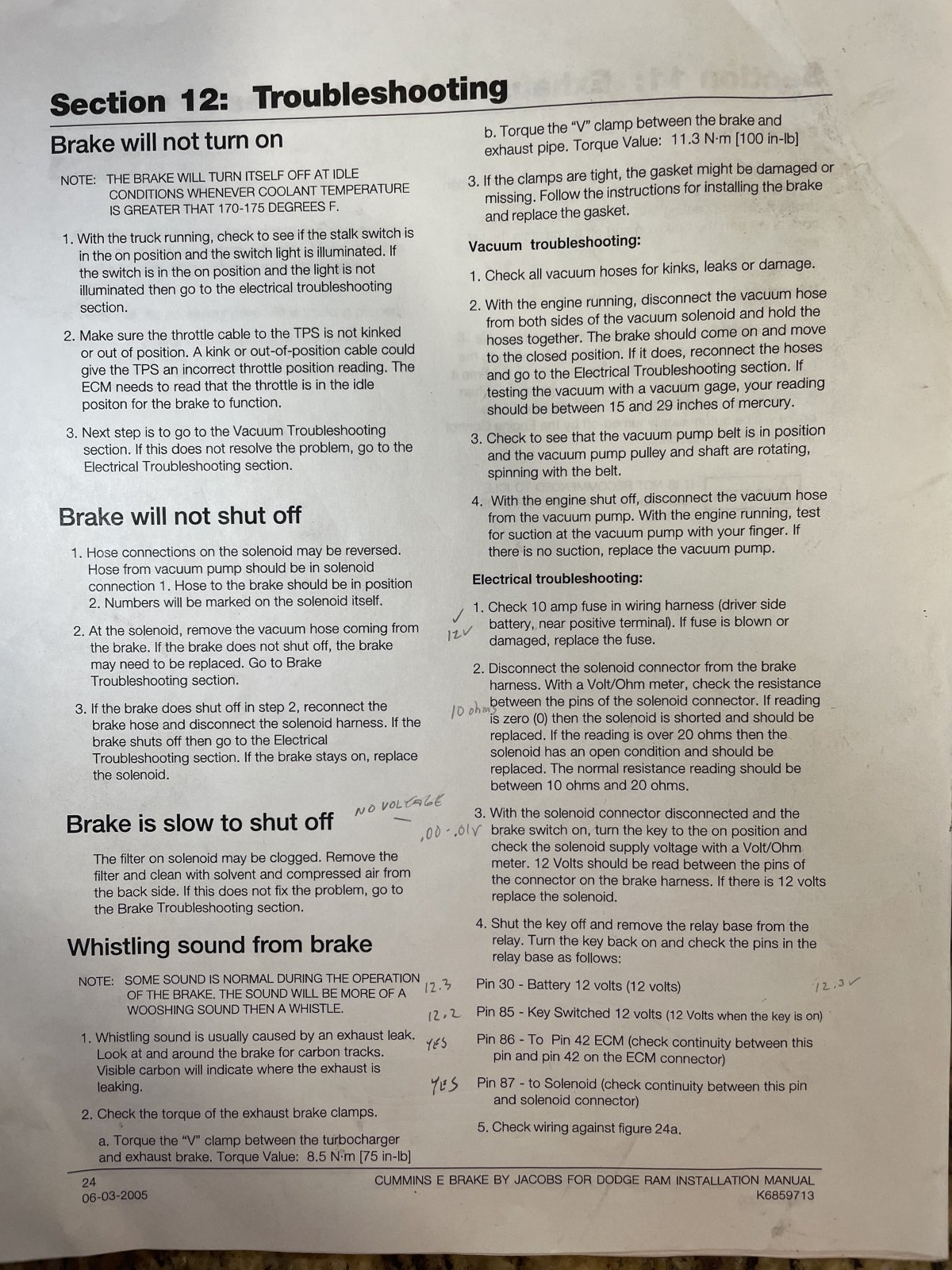

EB is still not turning on. I went through the Jacobs electrical troubleshooting on page 12 and 13.
Key on:
1. 10 am fuse good, 12v showing at fuse
2. disconnected EB air soleniod: 10 ohms. Should be good. Normal is 10-20 ohms
3. checked solenoid wires (solenoid disconnected): 0 volts w/ ignition and EB on. Should be reading 12 volts between wires.
Key off, remove relay base from relay, turn key back on:
Pin 30-battery 12 volts-checked 12.3 v
Pin 85-key switched 12 volts-check 12.2 v
Check continuity:
Pin 18 to Pin 42 ECM- yes
Pin 87 to solenoid- yes

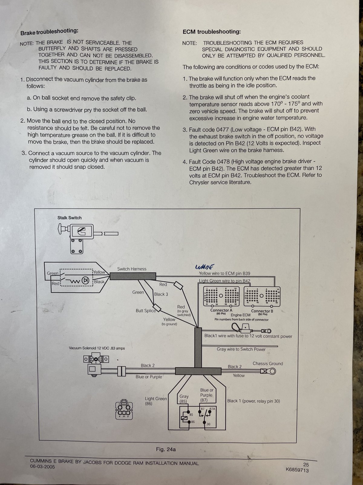

Ran truck and two codes keep coming back:
P0477 Exhaust pressure control low
P0478 Exhaust pressure control high.
Maybe ECM damage resulting in those two codes?
When the wiring harness to ECM B bundle was disconnected and batteries disconnected, I checked continuity from B39 to yellow wire going to stalk switch. It was good.
The LED in the stalk switch is very dim, that is normal.
If all the wiring is right to your measuring you should disconnect the battery's and do a hard reset, maybe your ECM is angry about the things that happened,
And yes, the shift pattern is changed, also the TCC lockup is way more aggressive. Your TCC is most of the time locked with the EB switch On.
Maybe you fried the ECM by having voltage at Pin39 because with the simple wiring intact you shouldn't get either code.
Code 477, how it works. With the EB not active the switched 12V from the grey wire runs through the relay coil all the way into the ECM and is measured. So it wants to see 12v all the time except when the ECM ground Pin42 to activate the relay and the EB.
Code 478 is an almost impossible code as the ECM knows the voltage of the whole system and expects to see the very same voltage through Pin42.
Is your ECM properly grounded?
What wires are we talking about here? Pin 42 and switched Positiv?
The two wires going to the exhaust brake solenoid. C11935 pnuematic solenoid.
This is wrong in the manual, this wire will only be live with the engine running and the EB active, means either cold engine or with speed.
