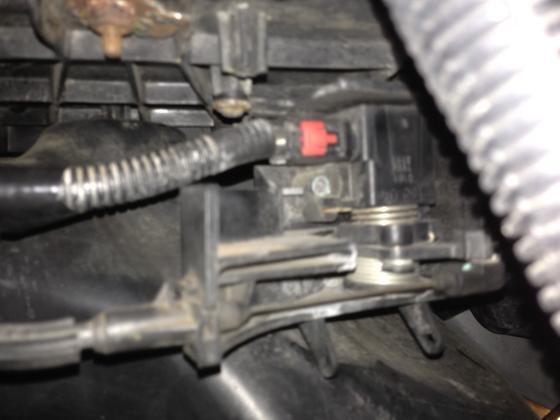

I attached the photo of my under battery sensor that I need. Is Your 04. 5 a Auto?
Don't go by what others APPS look like, your configuration is the only one that matters as they interchanged these things at times.
The picture oyur posted looks a lot like the ones on Hoesli's site. Can you get a better picture from the side so we can see the attachement spoints and form better? The straigth down shot doesn't give a good sense of the configuration. It looks to me like it is indeed like the ones I pointed you too but it tough to validate.
My sensor is hard plastic and the plug is part
Of the plastic casing. I will snap a picture.
The photo will be holding the camera near the stock fuel filter and looking under the driver side battery tray at the sensor. Sensor itself is above the spring.
Aw crap, sorry to hear that. Annoying they list that for 2003-2007 but it doesn't work on 03-04 trucks.
Evidently that was a one-off unit sourced by Dodge only, total pain if you can't find one. I wonder how hard it would be to convert to the engine mounted style.
I think I found the SOB..... !!!Oo.
I had to go up into an '05 truck to do it. It is the same as a 5. 7 HEMI which makes sense if you think about it.
53032456AD.
