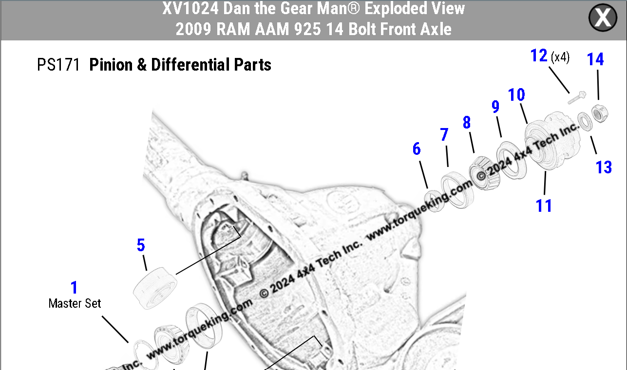

On the AMA front axle pinion seal, is there 2 seals or is one a dust cover or what? I see only a standard type pinion seal on Rock Auto, But watched some video that showed two pieces once the yoke is pulled off.
- One just pulled out by hand and the other was a standard type seal that you have to chisel out to pop it out.
-Or is there a exploded diagram of the AMA front axle parts anywhere?

Two seperate seals, 9 and 10 are the seals. Here is a link Torque king 4x4 is a great resource for parts with great information, I've gotten alot of axle components, and seals from them. I sourced my front pinion seal kit from them.

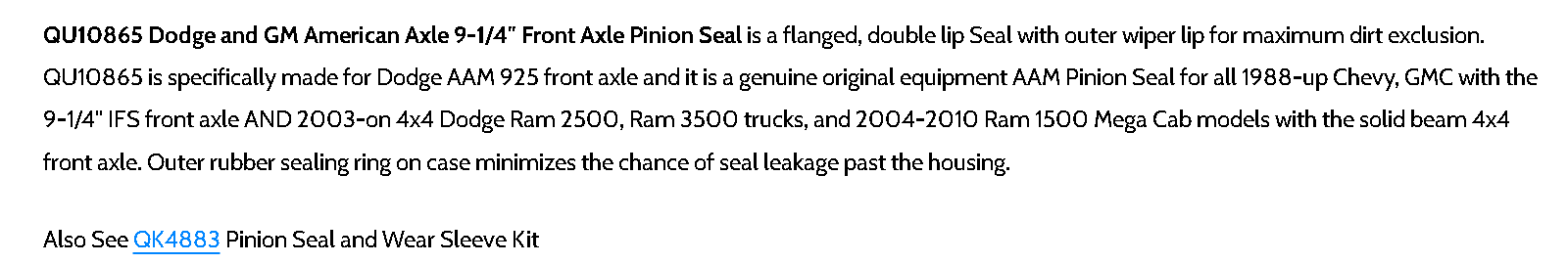

Dennys: Only one seal not two... #8
If you look at the part listing in the diagram you can see the year range for the application.
Its 03 and up , the 05 AAM 9.25 isn't exclusive in this application

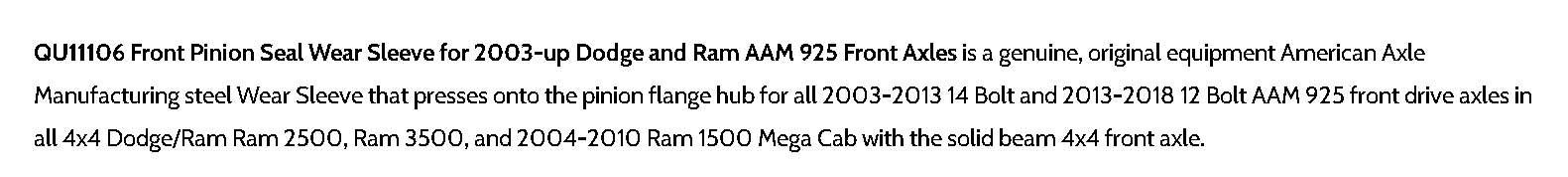

In their seal kit they include the wear sleeve, I thought to include it since its a wearable item that can cause a pinion to leak.
These are Genuine AAM parts if that matters to you.
