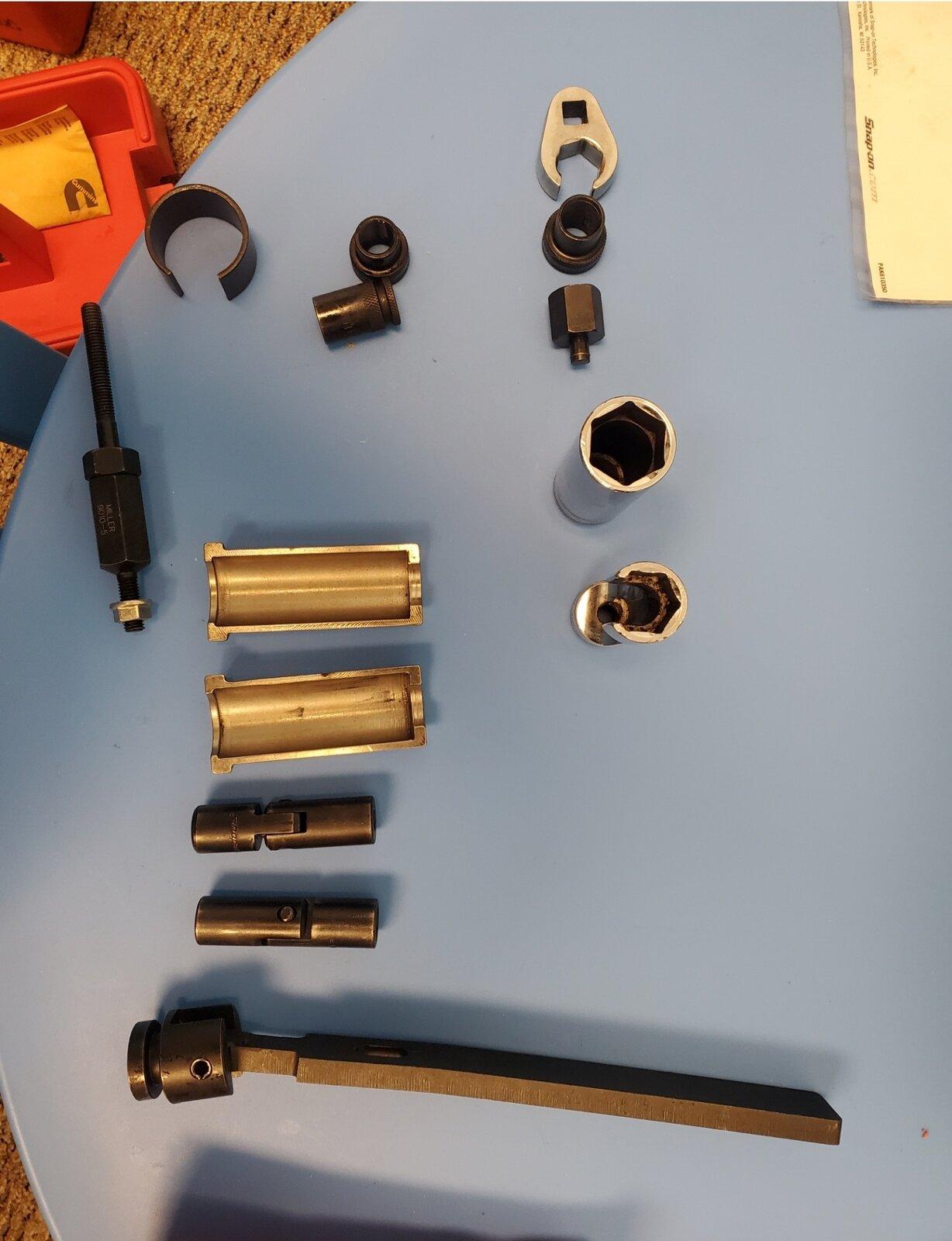

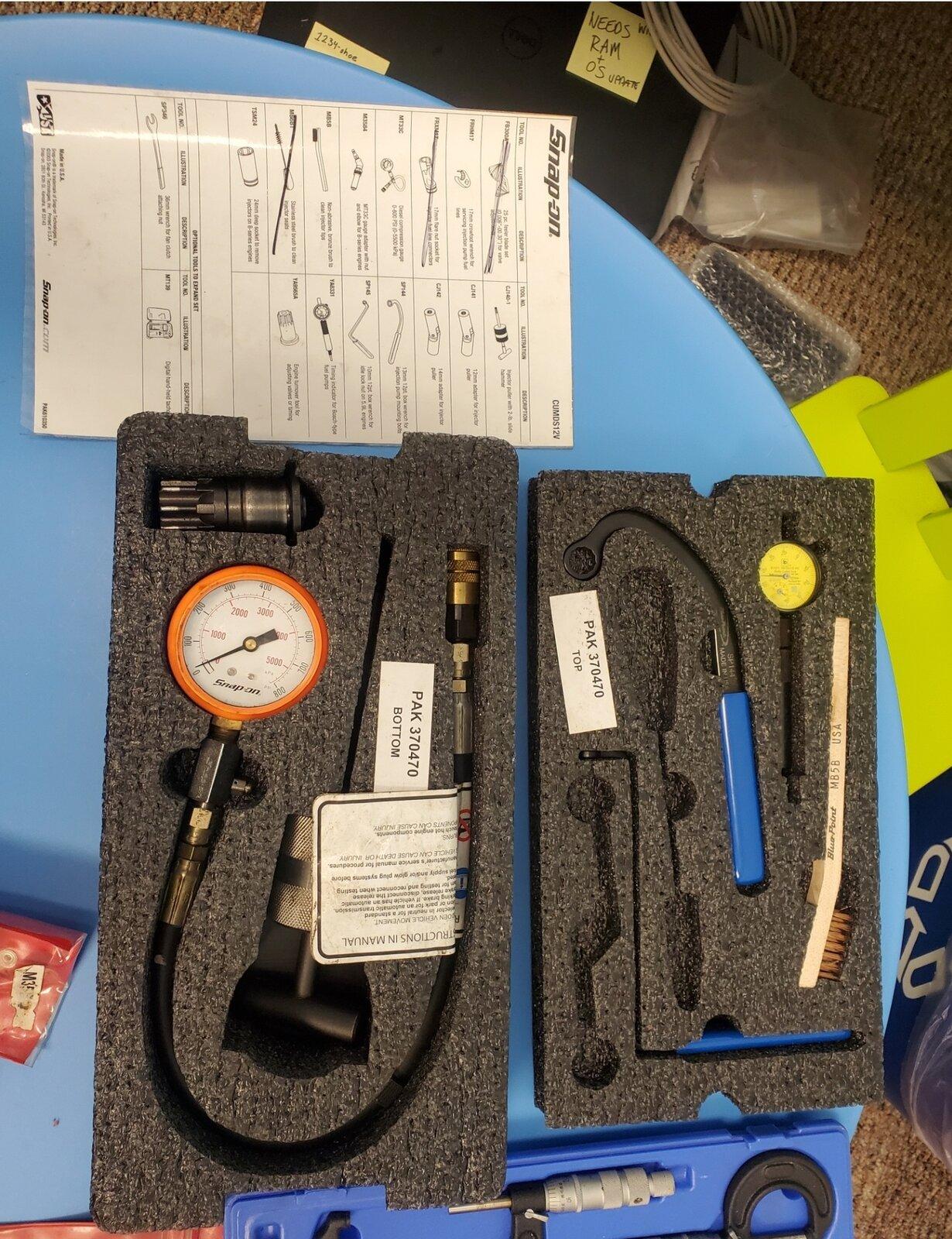

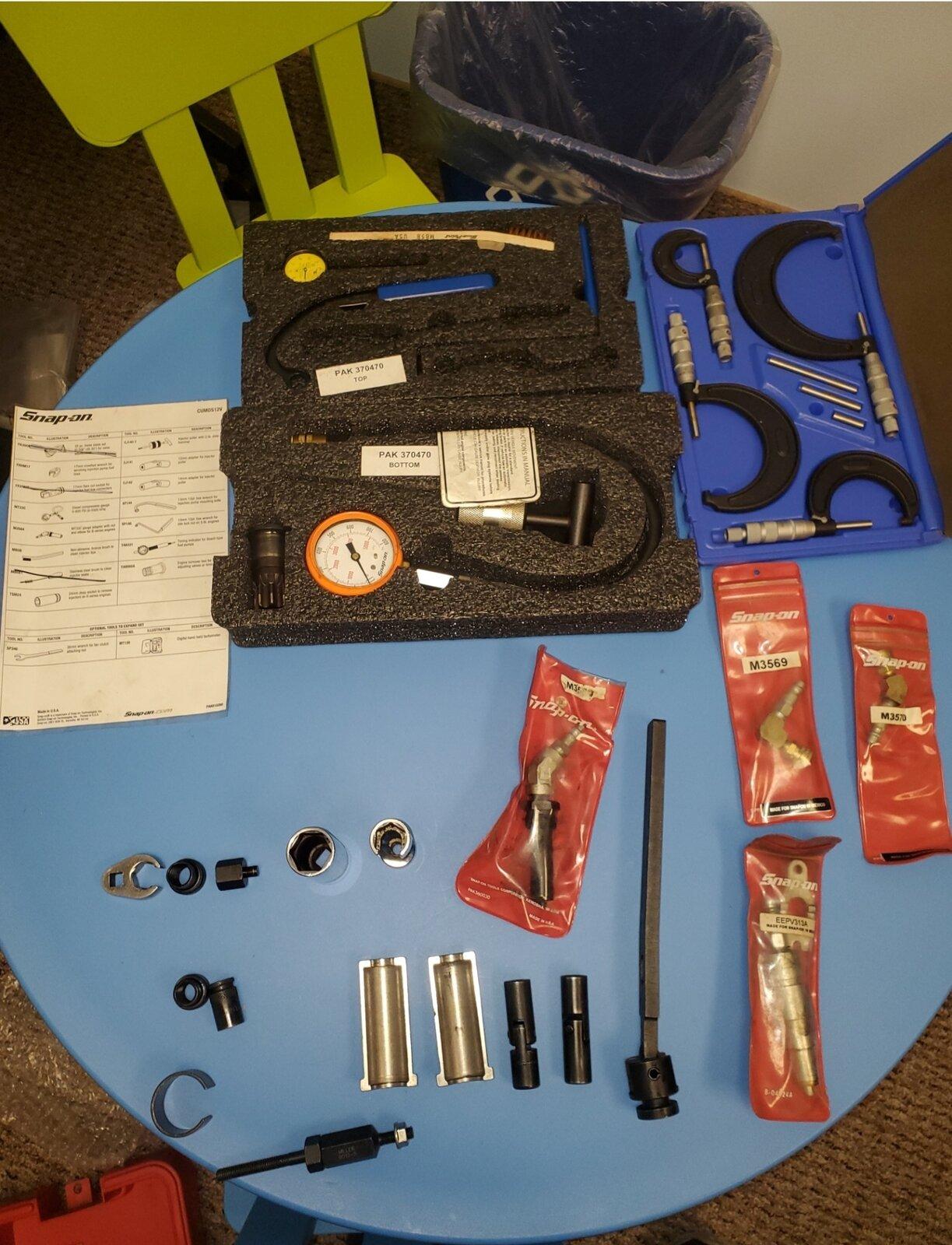

I have a specialty 5.9 tool set I picked up here from a member, I will take a look at what is actually in there, you would be welcome to borrow it if it's of use. It came with all sorts if gadgets, in general it was not selling to anyone so I picked them up.

I have an old friend who works for me part time was a machinist amongst a lot of things I will have him look over my stuff and let you know the condition and if it's decent enough to use for something like this. It's all stuff like Central, Snap-on, and other mechanic grade stuff.
Others might have to help ID some of it and if it's really needed with the engine torn all the way down as some of it is for use with the accessories installed.

Thanks, appreciate the offer. So far I've picked a barring tool and a 4 valve compression tool from Geno's. I'd previously bought a fan wrench from Geno's. Already used the wrench, and bought the other tools in anticipation of use. I think I might have to buy a ring compression tool but I hope not. If anybody knows a good hack for ring compression I'd appreciater that too.

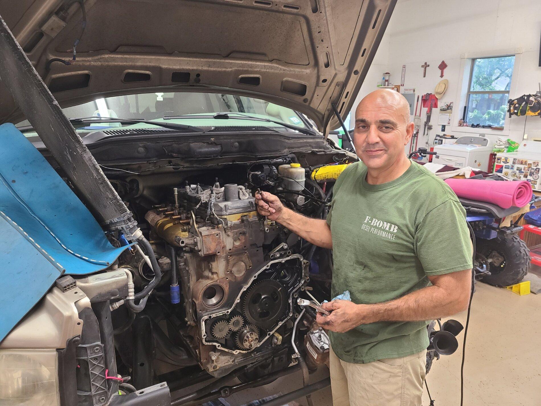

Gonna see if I can pull the engine this weekend. Hoping my Harbor Fright engine stand will hold the 6BT w/o crushing like a millennial at a blue collar job. Will post picks when I can. Yall please keep the advice coming.
