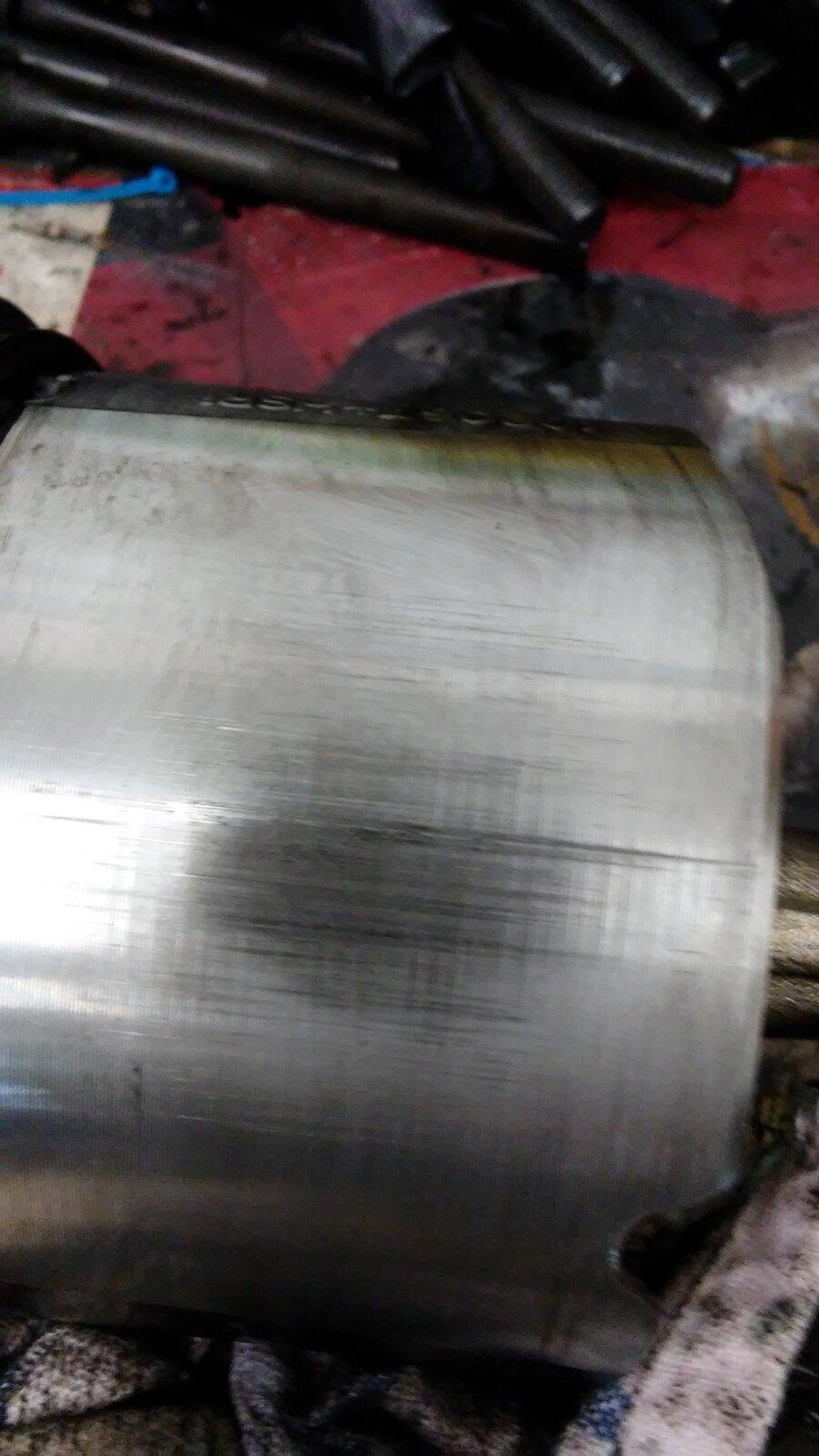

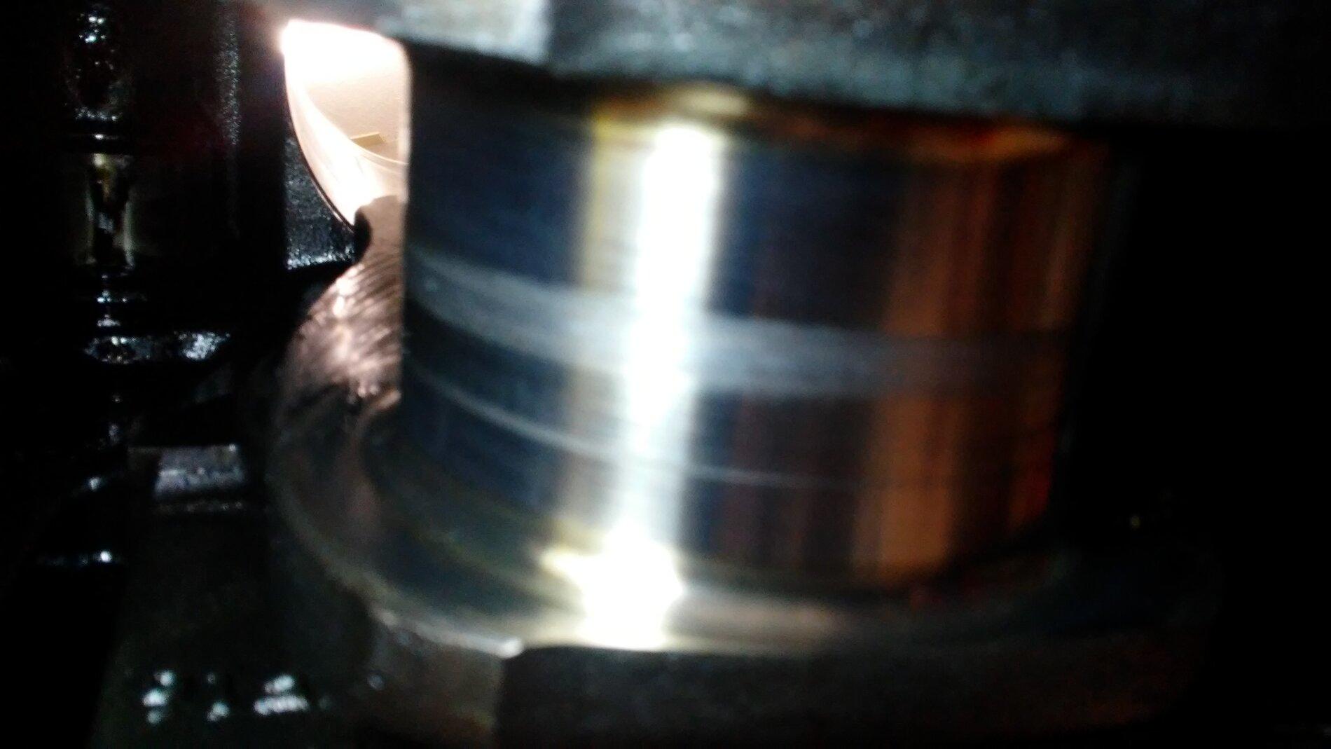

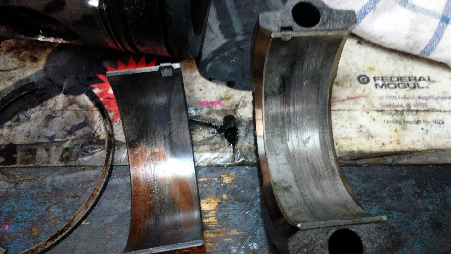

That last pic is the crank journals on #6. The neighbor journal in #5 is only slightly better. Neither one can be snagged with a fingernail.

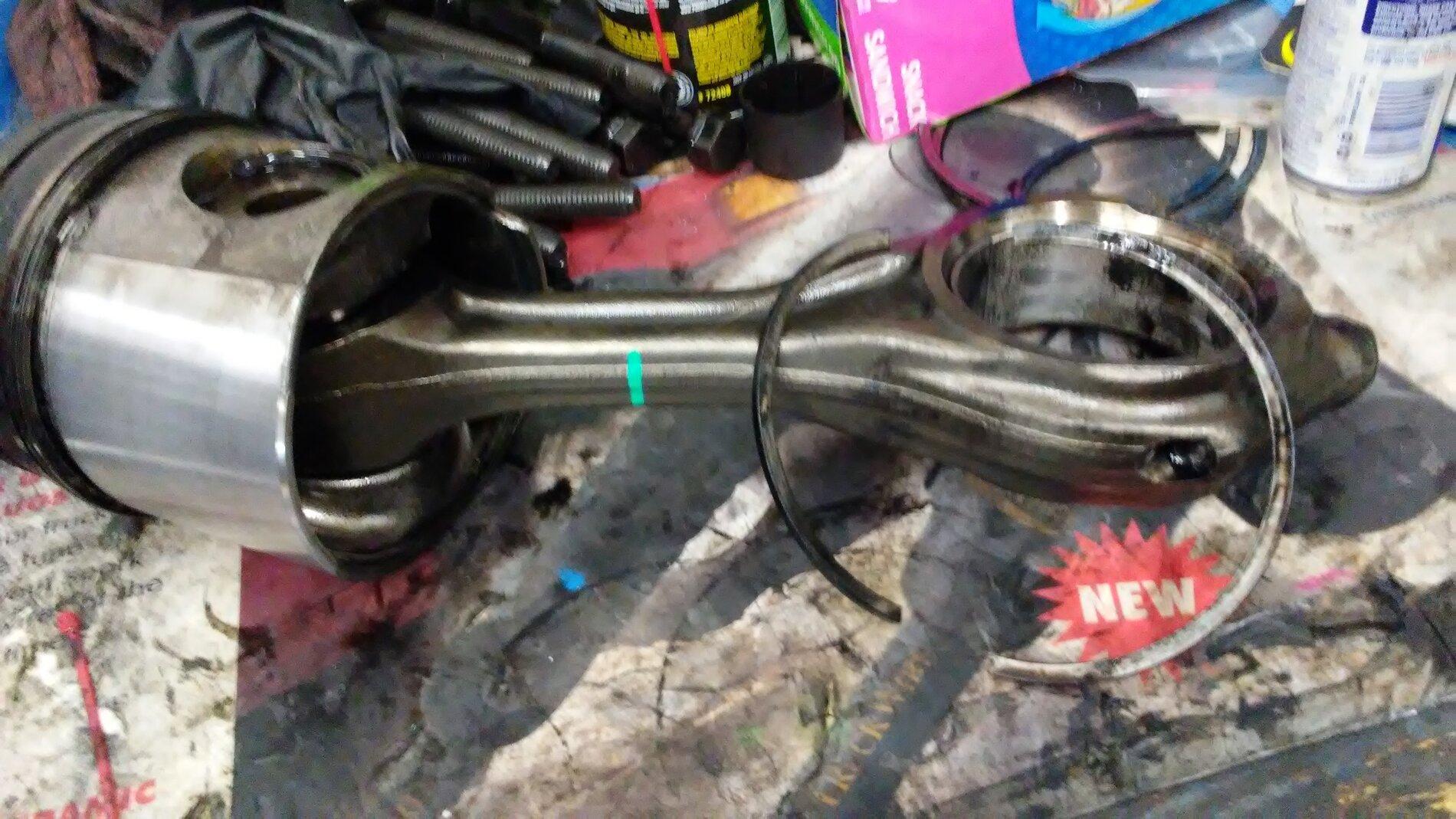

The picture just above is the piston skirt on #2. Not sure why, but the corresponding cylinder doesn't look bad. I'm hoping the cylinders will hone out and the bearings will pass a plastiguage check. Like the title states I'm on a budget.

Also looks like my turbo may have been leaking some oil internally. Truck actually ran strong considering the leaking turbo, broken rings, two bad rod bearings, and piston slap on #2.
