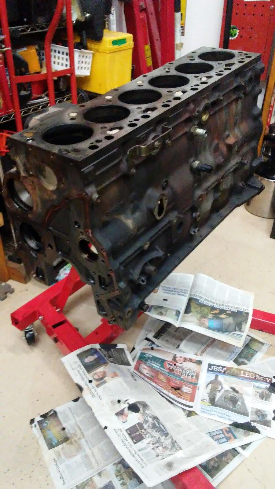

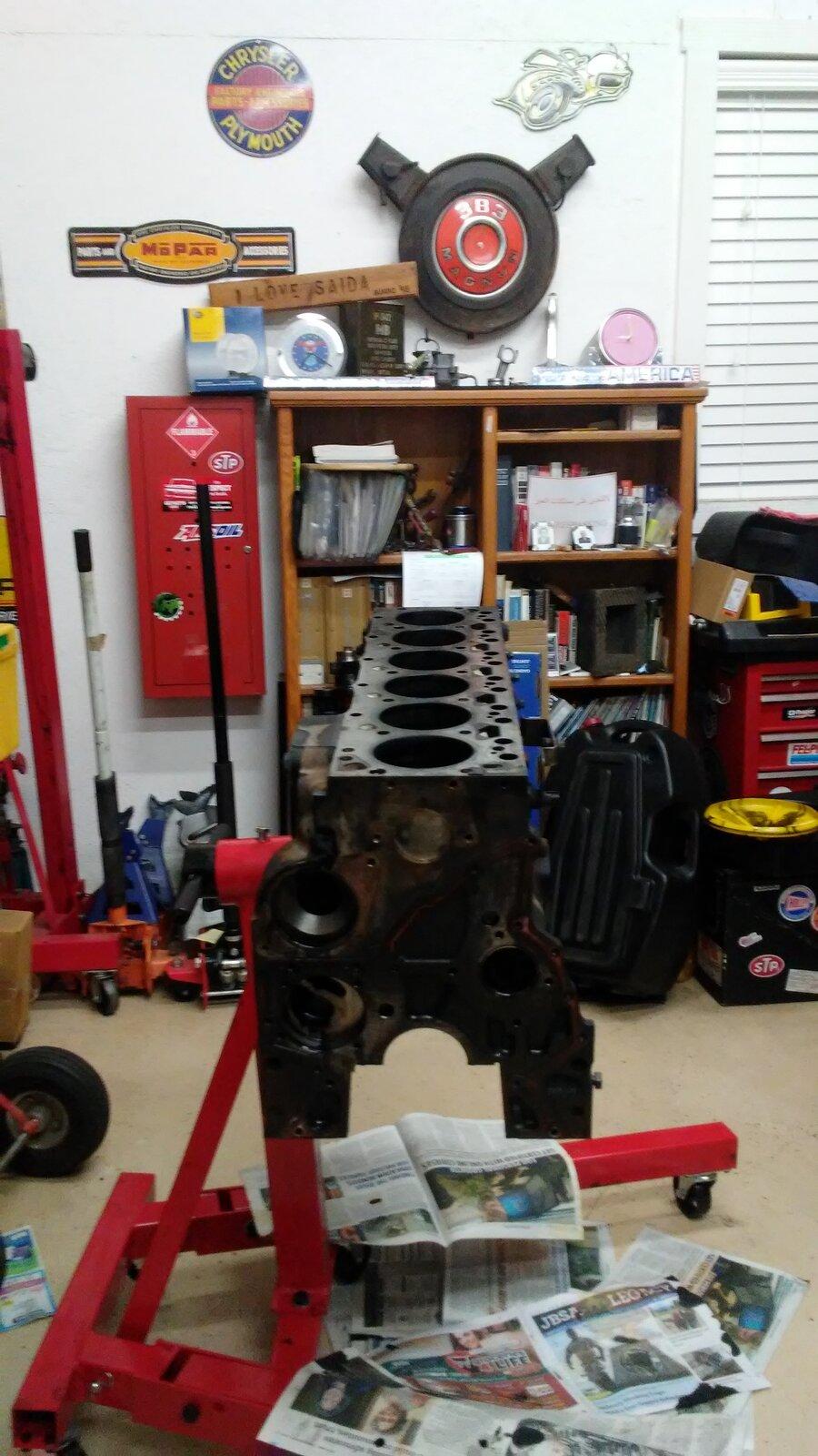

Got it down to the bare block. Cam shaft and crank mains looked good. This weekend I plan on honing the cylinders then taking an emory cloth to the crank-to-rod journals. Hope the ring end gaps meet specs when I'm done.

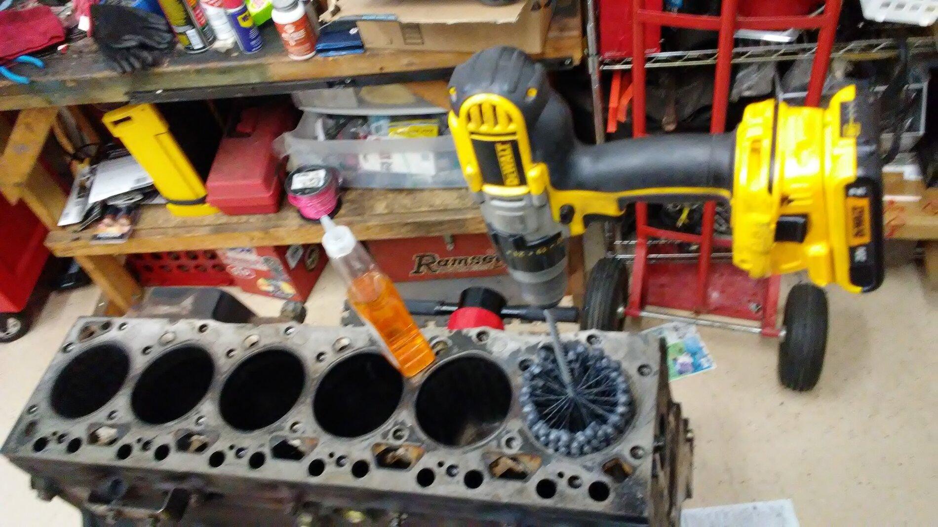

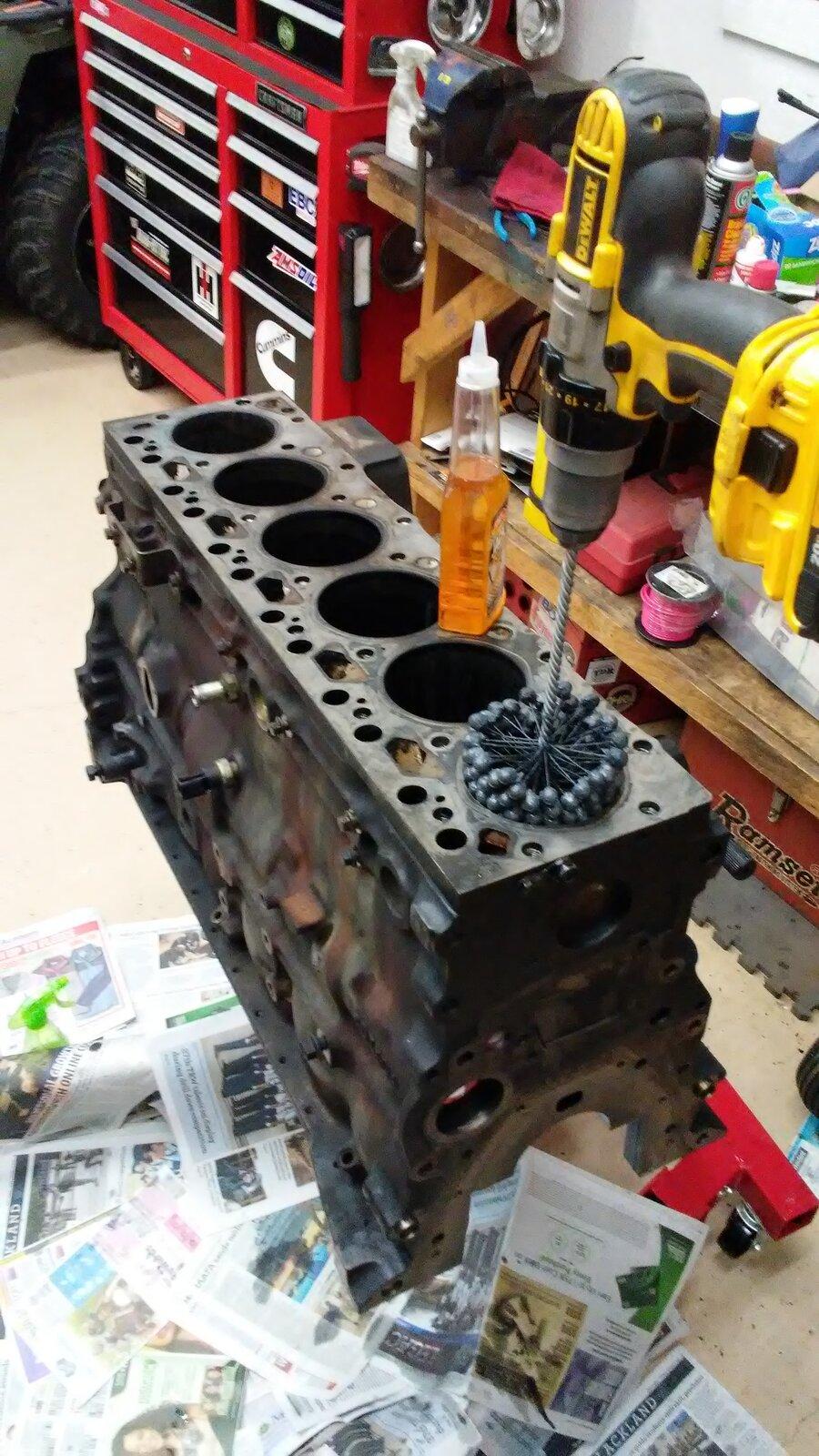

Finished all the cylinders, went to grab a ring to check the gap and see if my budget rebuild was still on track or gone off the rails.
Surprise! Rings weren't in the kit I had. Thought I was only missing the oil pan gasket...wrong.
So now I have to wait until tomorrow to call up Utah and see what gives.
The smart guys out there are saying, "hey, Dysfunctional, go grab a micrometer (or was it an abicus I always get those two confused). Anyways I don't have either and I was just trying to see if this block could avoid the machine shop and putting a second mortgage on the house.
