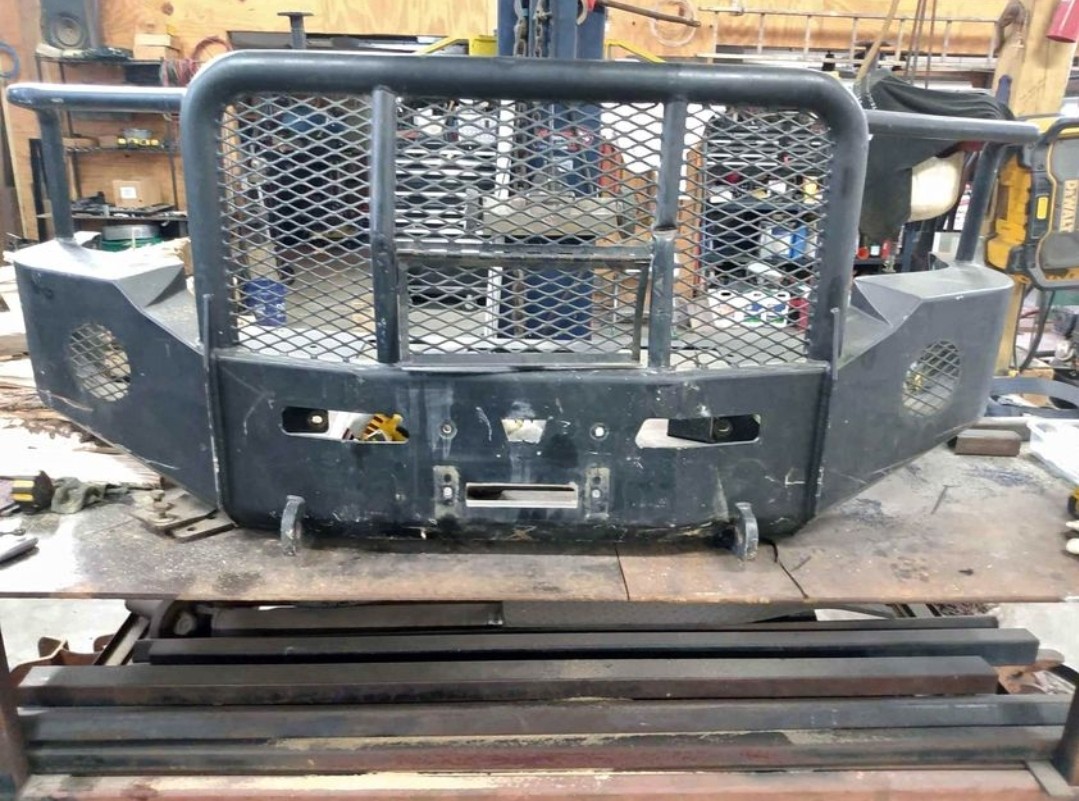

Me being cheap and marketplace being a temptation like no other... I stumbled upon a old warn bumper off an 07 F350.
I've been looking for a bumper for a while now but didn't want to shell out Ranch Hand money. I have some fab work lined up to be done in February on my 03 and was considering adding custom bumper mounts to the tab.
Anyone ever tried this? Thoughts? My focus is on protection, asthetics come after functionality for me. I plan on running this by the fabricator before I make an offer on it. Comes with Ford mounts. I estimate the weight around 190 ish.
Woof.. that's alot of metal. I have fabricated many things over the years, anything can be made to fit anything......
That being said, it depends on how you are about fit and finish, there likely is alot of work to be done to make the form fit, so if you're okay with gaps and odd angles, Im sure it'll go. not sure how much re-work it would take to make it right, If it was my money, I'd keep looking for something at least off a RAM.
JM2C. best of luck.
Probably more work than it’s worth. Body lines won’t even be close, even if you don’t care about appearance it still has to sit in place and not block airflow.
Cut to fit is defiantly an option on the table but I'll take your word for it on the work it'd need and pass on it. Thanks for the feedback.
