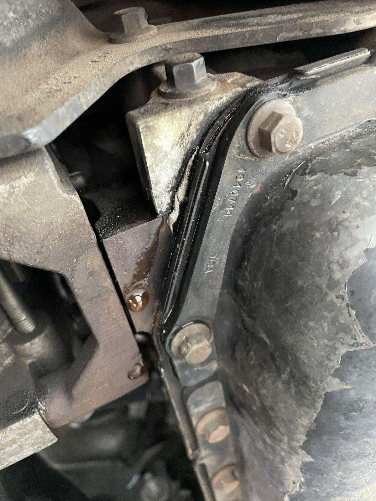

I noticed a coolant leak on the bottom right side of my engine. Does anyone know where it might be leaking from? Is this we’re the weep hole from the water pump leak to?
thanks!
I'd say so, yes.
You should see it, it can also be the radiator hose connection just above the AC compressor.

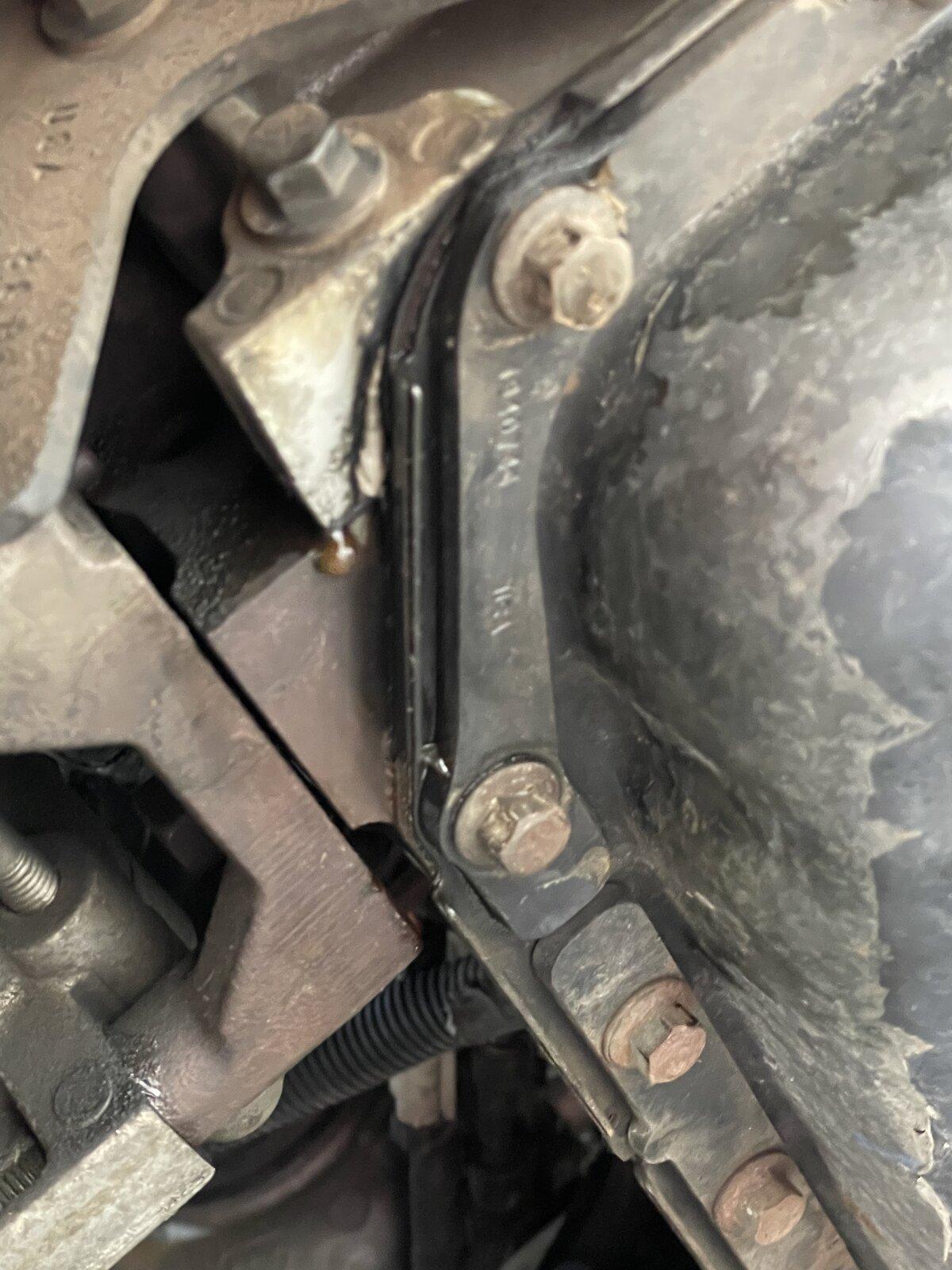

thanks!
There’s a square type “o” ring between the engine & the bracket the air conditioning compressor bolts to. You can find an exploded view by searching moparpartsgiant.com
Hope this helps.
