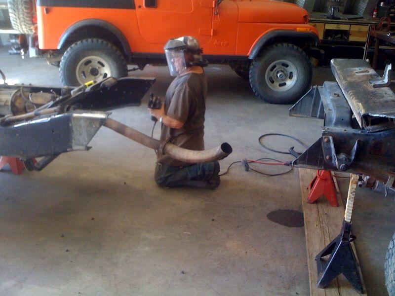

So far, I have torn the 93 apart, shortened the frame (~42. 5" cut out), and re-did the rear spring setup. I put on a pair of ~64" long chevy rear leafs from a half-ton 2wd. Mainly for ride quality and travel. Up front I am going to use 52" long dodge rears.

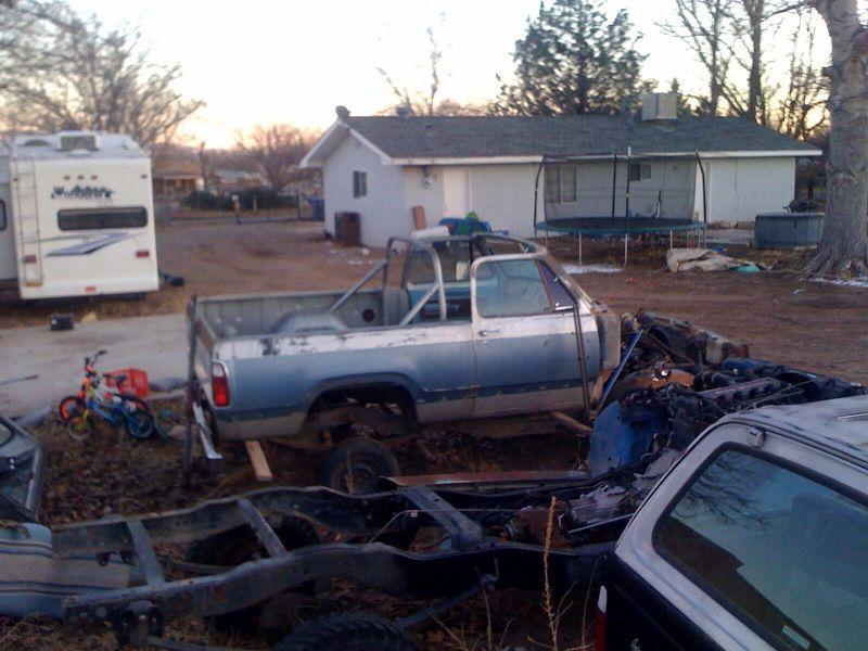

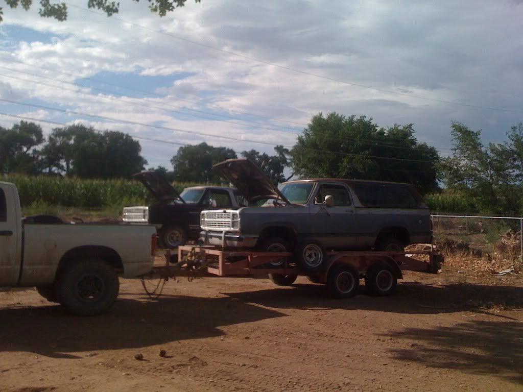

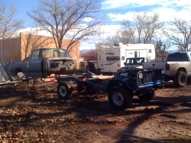

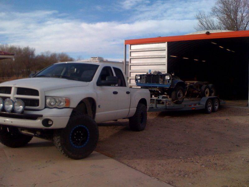

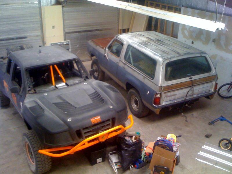

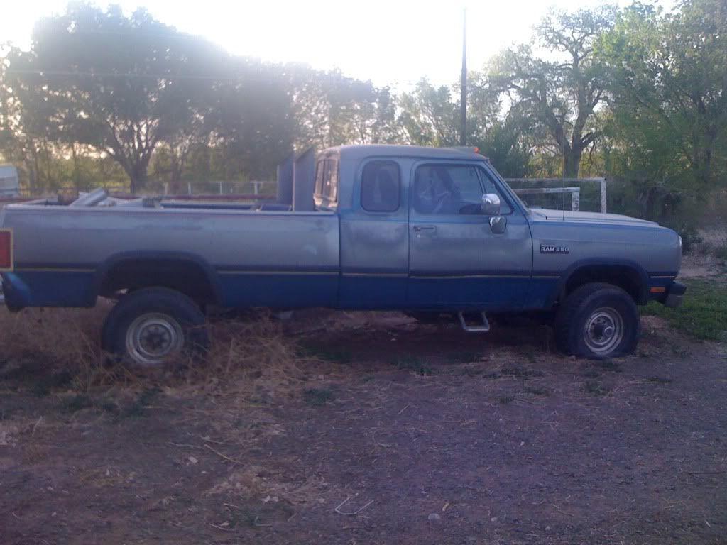

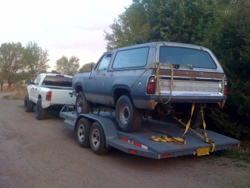

Here are a few recent pics. I will post some up later of the truck when I started, and the RC's.
--Jeff
Some pics of the Truck and RC. I will post more later.

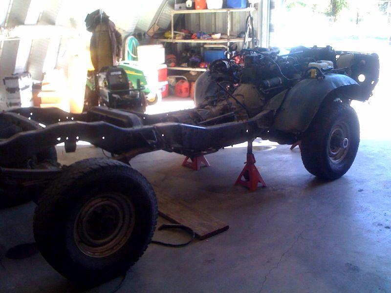

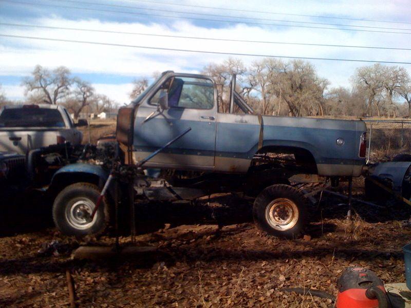

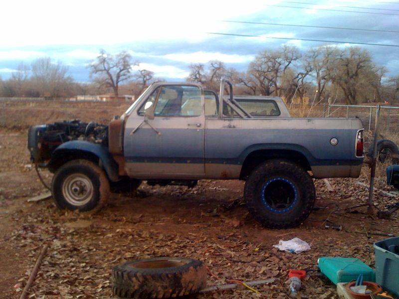

EDIT 10/31/17: I noticed that all of the early pics in this thread disappeared. Must be because of photobucket being a POS. Here are some random ones...I dont think these are all of them from the past but at least here's a few to get the idea.
Few more random pics. Just some in progress stuff. I will try to keep up more now...

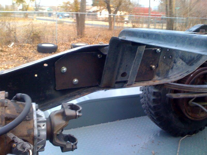

I like how you plated behind the relocated spring mount. Are you planning on boxing in the frame at all?

So the "cut" is actually right between the relocated spring hanger. Its at an angle. So I moved the crossmember along with the spring hanger, just to add rigidity where I welded it back together. I was originally planning on boxing the frame where I cut it, but since I moved the crossmember I dont think its necessary. Also since the cut is "inside" the spring hanger, I think the bending stresses there will be minimal compared to if it was forward of it. Thats partly why I plated behind also, since I cant really box that entire section now. The plate thats bolted in there is 3/8" thick haha... My dad had it laying around so we just used it.
