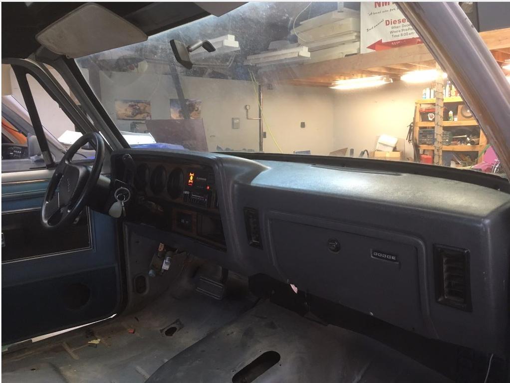

In the few evenings I had, I knocked out little things like getting the dash from the 93 swapped into the 79 tub, finishing body mounts, re mounting the 64" rear leaves because I didn't like the way they came out the first time, realizing that my new mounts are now in the way of the middle body mount, etc. After I was ~90% of the way to it being reality that it was actually going to make it to Silverton this year, I sold the samurai to give me even more motivation.

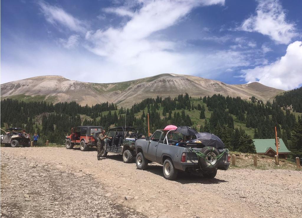

We left at 6 the next morning and headed to Colorado with a box of parts, tools and bacon. After I got the motorhome all setup, I finished installing the seat belts and other little odds and ends. I hadn't quite got the rear lights figured out, the fuel sending unit did not work, and I had totally spaced windshield wipers. Oh well...I'd have to make due. I grabbed some friends and took the top off and went for a little ~10 miles trail jaunt that night just to make sure I wouldn't ruin everyone's fun the next day. There were ~40 people with us, mostly in UTV's and jeeps. We had friends and family with us from Louisiana to Phoenix, bust mostly from the Albuquerque area.
The first day we did a ~half day trail close to camp. About an hour into the trail, antifreeze began pouring down the firewall inside. Figured I popped a heater core. Opened the hood, nope...had a heater hose blow off! It was missing a clamp. First problem, easy fix. Filled er back up with Rocky Mountain Stream Water. The brakes began to get a little squishy, but I had expected that as I had bled them once, with all new parts and figured there had to be some air left in there. At the top of the trail I looked and one of my new rear brake lines was leaking, but I had spares and a flaring tool back at camp. Ended up just being a little loose at the junction block below the master cylinder, easy fix #2. As the day went on, the rear developed a clunk. I figured it was a shackle/leaf spring bolt, or perhaps the muffler banging on the crossmember. Well, the 20 yr old POS rancho 9000 shocks had dry rotted bushings, that evicted themselves. I made some new ones out of heater hose and fuel hose back at camp, easy fix #3.

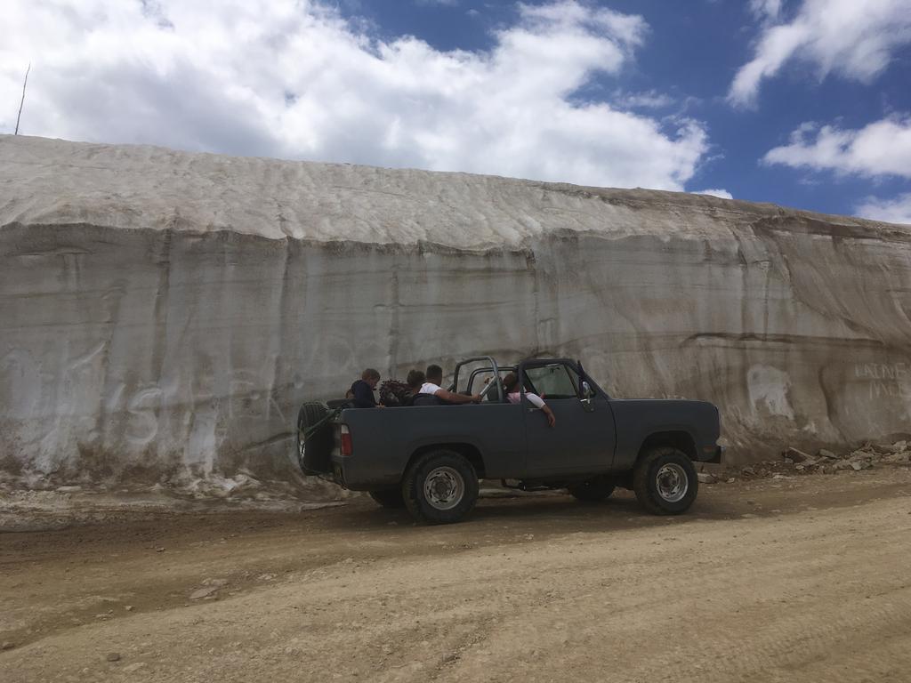

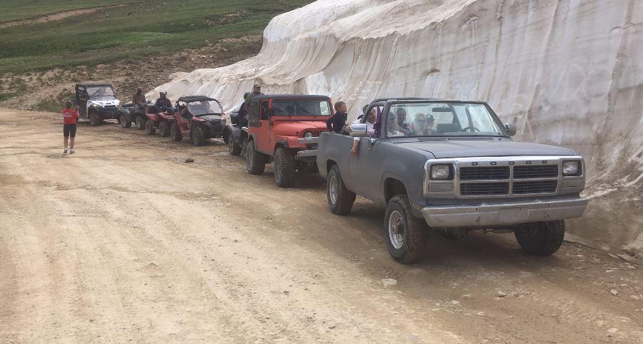

Day #2, we did a long trail to Lake City. I put a 3rd row seat in the RC with 4 seat belts (kid sized), and a few friends that came brought their rock crawlers on Stickies, and they hate driving them on pavement. So I had 10 people (5 adults and 5 kids) in the RC that day. It performed flawlessly. I hadn't even had to lock the hubs in yet. By the end of the day, my homemade shock bushings had gotten a little loose but that was the only issue all day. I ended up making new bushings every morning, and that was the only maintenance it required the remaining 8 days.
In the end, over 10 days I put 417 miles on the RC, ~400+ of it was dirt, and those were the only issues it had. I have about 1K miles on it now. The rear springs have settled a bit like I expected, but other than that, its a ton of fun to drive. I still haven't fixed the fuel sending unit, wipers, or put a back bumper on it. Next on the agenda is suspension. I am 10000% pleased with how the 64's ride in the rear. Ill throw some rezzie sway-a-ways I have back there, or perhaps some new 7100's. I am still torn between some ORD spec Alcans, 52" rears up front, or just radius arms and coils. Every day something changes my mind. Right now, I'm in the radius arm/thuren coil/smooth body shock mindset. Tomorrow it will be 4 link and coil overs. Who knows where it will end up...but I have a new set of 37's waiting to go on.

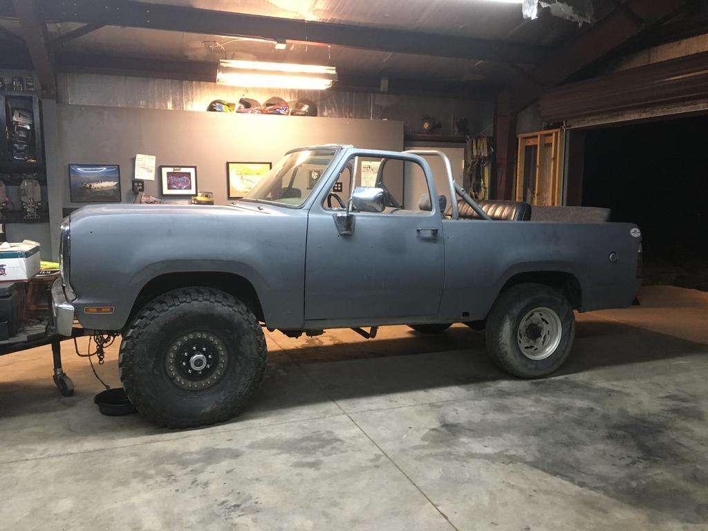

The way it sits right now, it has a dana 60 front/14 bolt rear with 4.56's. I shaved the rear 14b for clearance. Now that I have a full fledged purpose built rock crawler, the RC's purpose is more do it all. I don't want to go taller than 37's. I want to keep it low (~4-5"), trim fenders, make it ride nice, flex ok, and work as good as my 3rd gen in the whoops. Power wise, the Don Morrison/Joe Donnely injectors, pump mods, hx35/14cm wg, and banks intercooler is a great combo. With the little 32's and 4.56's it will roast the tires just before the shift into 3rd, but it doesn't like to go much faster than about 70 before it feels like I am abusing it. The 37's will fix that. The seating for 10 is super cool. 4 kids fit great in the 3rd row bench (stolen from a 2nd gen quad cab). Behind the 3rd bench I have 2 tuffy boxes full of tools and spare parts, with enough room between them for oil/antifreeze/etc.
Still on the list; Paint/bedliner, suspension, bumpers, lights.

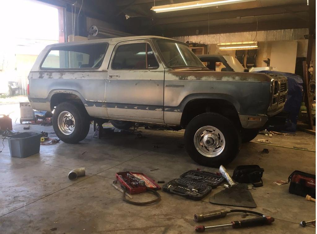

A few pics I have:

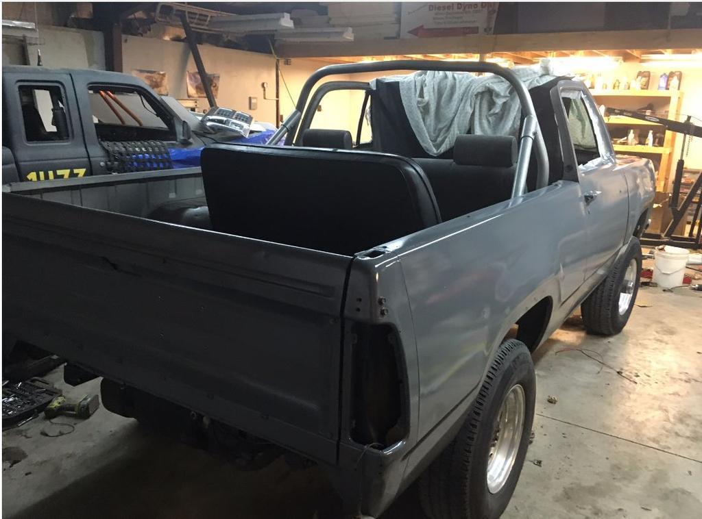

Pretty much where I started memorial weekend. No dash, most of the suspension mounts just tacked in, no body mounts, no exhaust, wrong perches on the rear axle, no brakes, no steering, etc.

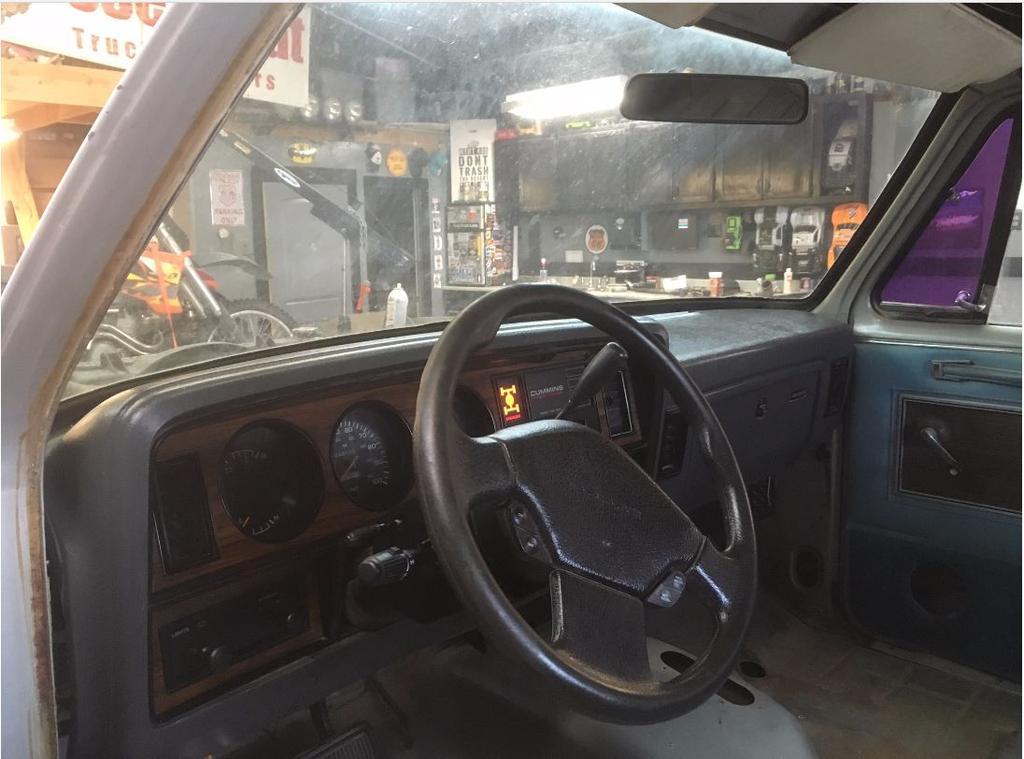

Dash in:

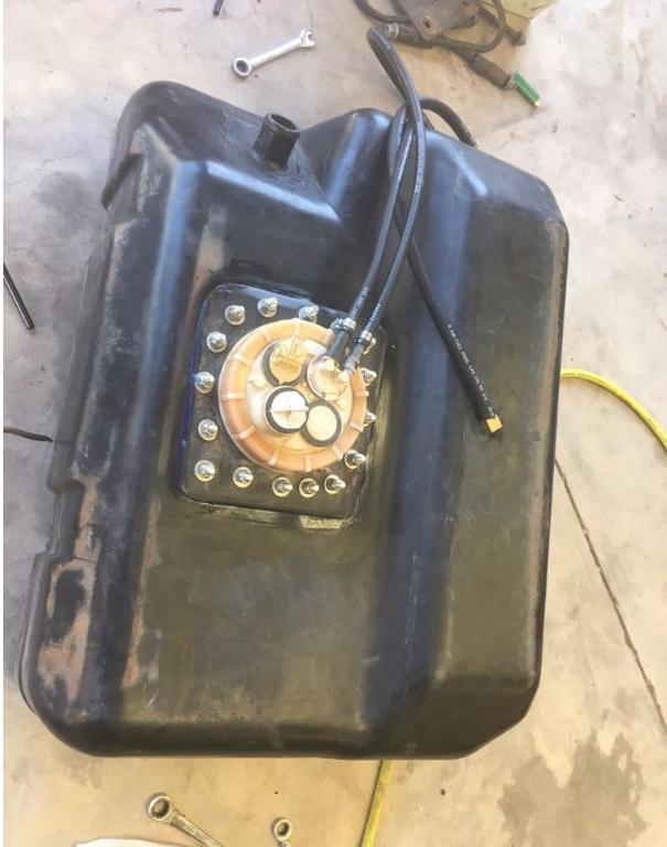

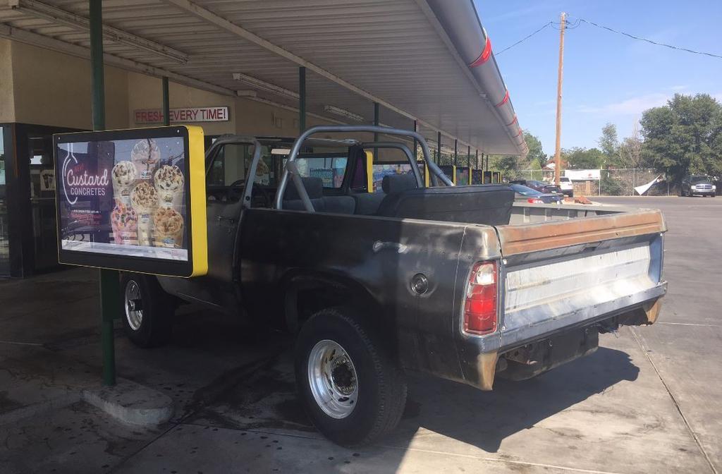

Cut a hole in the tank, and grafted the top of the CTD tank onto it.
30 minute paint job:

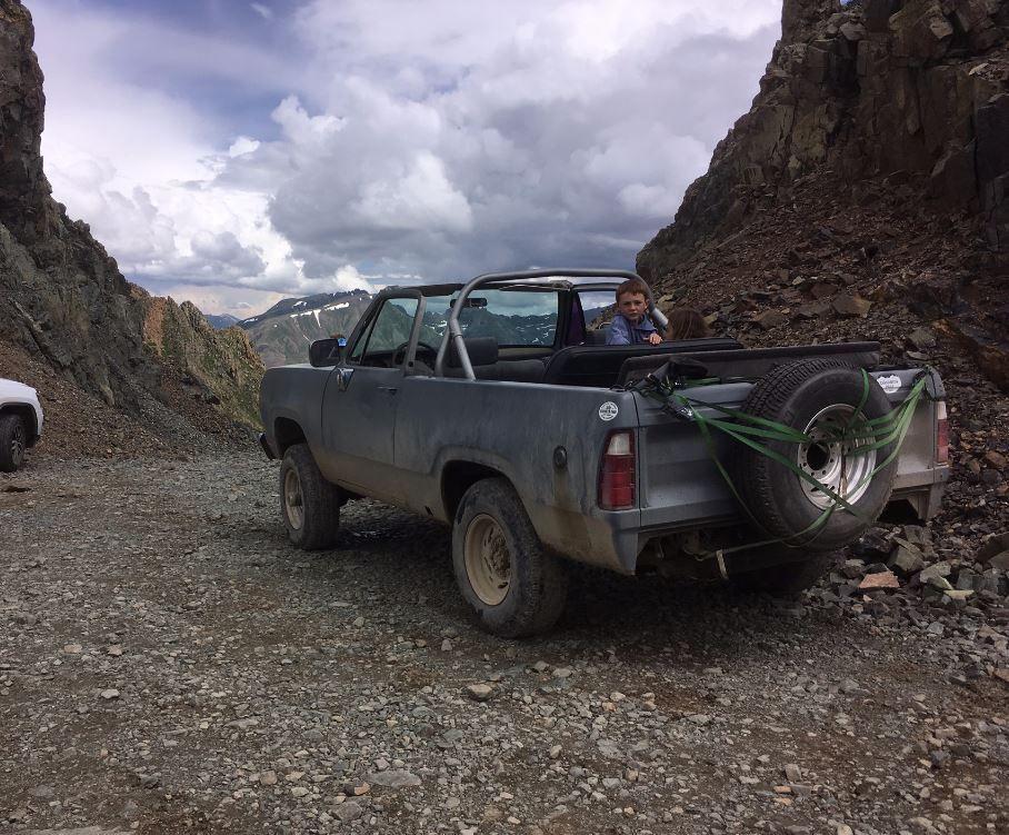

Random pics from the trip:
And a little tribute Picture. My grandpa (Chuck Peeples) was an avid Diesel/Cummins enthusiast his whole life. He was a TDR member for a long long time. He passed away in 2011. We spread his ashes on top of Kendall Mountain in Silverton. He was a trail guide up in the San Juans and took me up there every summer as a kid. Hes the reason we still go up there every summer. This picture is the Cummins RC parked where we spread his ashes, I'm sure he was smilin'.
That's it for now. Ill try to remember to update this as I make changes/upgrades.
P.S. For those of you wondering, the spare tire stayed on the tailgate with ratchet straps the entire 10 days without flaw. It outlasted numerous sets of shock bushings. :)

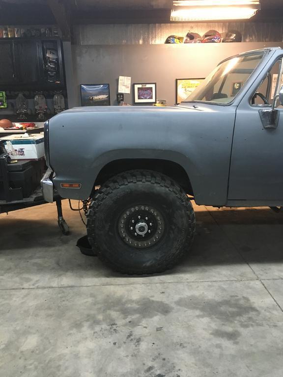

Not much of an update. Workin on getting the 37's to clear. I've been messing with backspacing and such. I would like to end up with ~6" bump travel and 4" lift, which means I need to raise the factory bumpstops and check clearances. I'll probably do some trimming, pull out 2 leafs, raise the bumps and see what it's gonna take to get clearance there.
