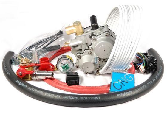

Is this the set you have Corey? . . I see this on Ebay . . Also what "type" of tank do I need? 1,2,3 or 4?
Not sure if that is the kit. Looks close, but the regulator is different.
