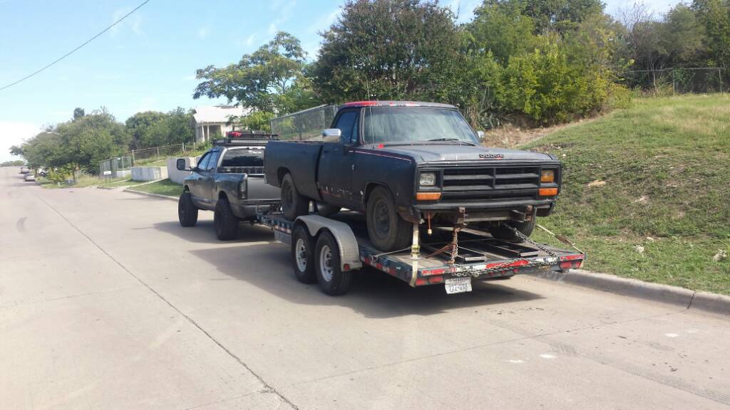

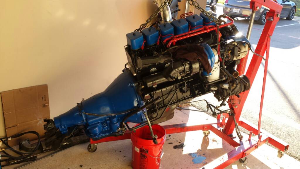

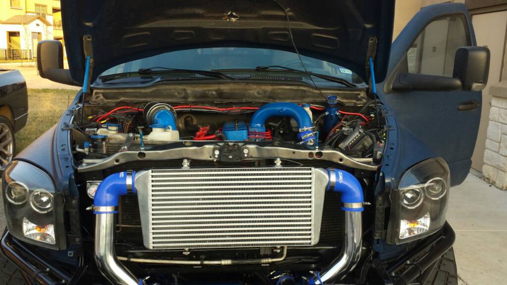

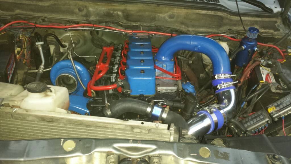

Here is a list of what I have bought for the swap besides the complete donor truck...
Radiator hoses
12 quarts of mobil one motor oil
12 quarts of atf+4
Wix Oil fiter
Wix transmission filter
Hx35w turbo
Adjustable turbo elbow
Xs power intercooler
3" intake horn
4" turbo back MagnaFlow exhaust
6" hex tip powder coated royal blue
Intercooler 3" universal kit
Sunpro oil pressure mechanical gauge
New motor mounts
Rear performance billet freeze plug
Glowshift gauges- Boost, egt, fuel pressure, vacuum, and Trans temp
Autometer overhead console 4 pod holder
Maxtow a pillar 4 gauge pod holder
Push to start button
Billet side freeze plugs
Billet tappet cover
Billet intake plenum
Grid heater delete
Oil catch can with breather
Beans diesel sump pump
Fass titanium fuel pump
Fass Fuel filter
Kdp kit
New gaskets everywhere
Blue hood pin kit
Bd fuel pin
3200 governor spring
New water pump
Redone head
Milled pedestals
Arp studs
New 40 hp injectors
Custom trans lines
Custom ps lines
Custom shifter cable
05 f350 long bed 4x4 driveshaft with all new u joints and carrier bearing and correct weld yoke
There is a bunch more little things that I'm sure I'm forgetting. I'll try to add as I remember.
