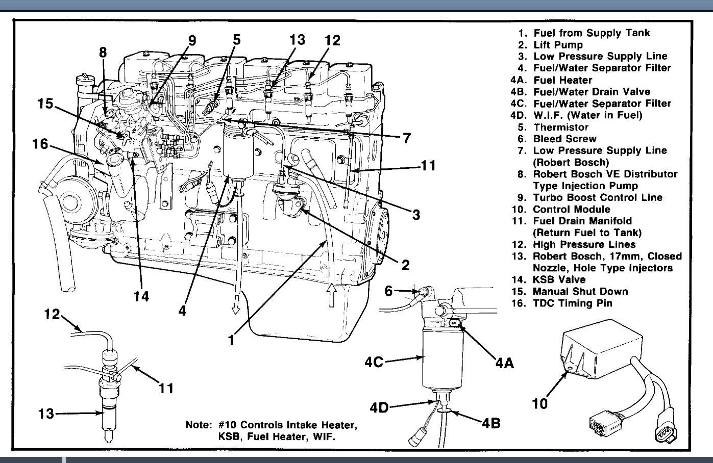

From the book:
The engine is equipped with a cam-actuated lift pump. Fuel flow begins as the lift pump pulls fuel from the supply tank. The pump supplies low-pressure fuel (21-35 kPa, [3-5 psi]) to the fuel filter head, through the filter and then to the distributor injection pump.
Fuel System Bleeding (by the book) might be an easier way someone can share.
And make sure Shutdown Soleniod is doing its thing. Never know.
Good luck with your fix...
Lift Pump Info
Thanks so much Timd32
I appreciate the follow up with diagrams and test procedure.
Also, appreciate the comment on the heater screen. I will save that for another day.
So here's my plan, please comment if I should go about it differently..
I will replace the fuel filter, prime it and see if the truck starts and keeps running..
If not, run to NAPA and buy a new fuel pump.
Any suggestions on fuel pump brands or what to look for?
Any suggestions on installing the fuel pump?
The Diagram really helps, nice work, thanks again for your help.
