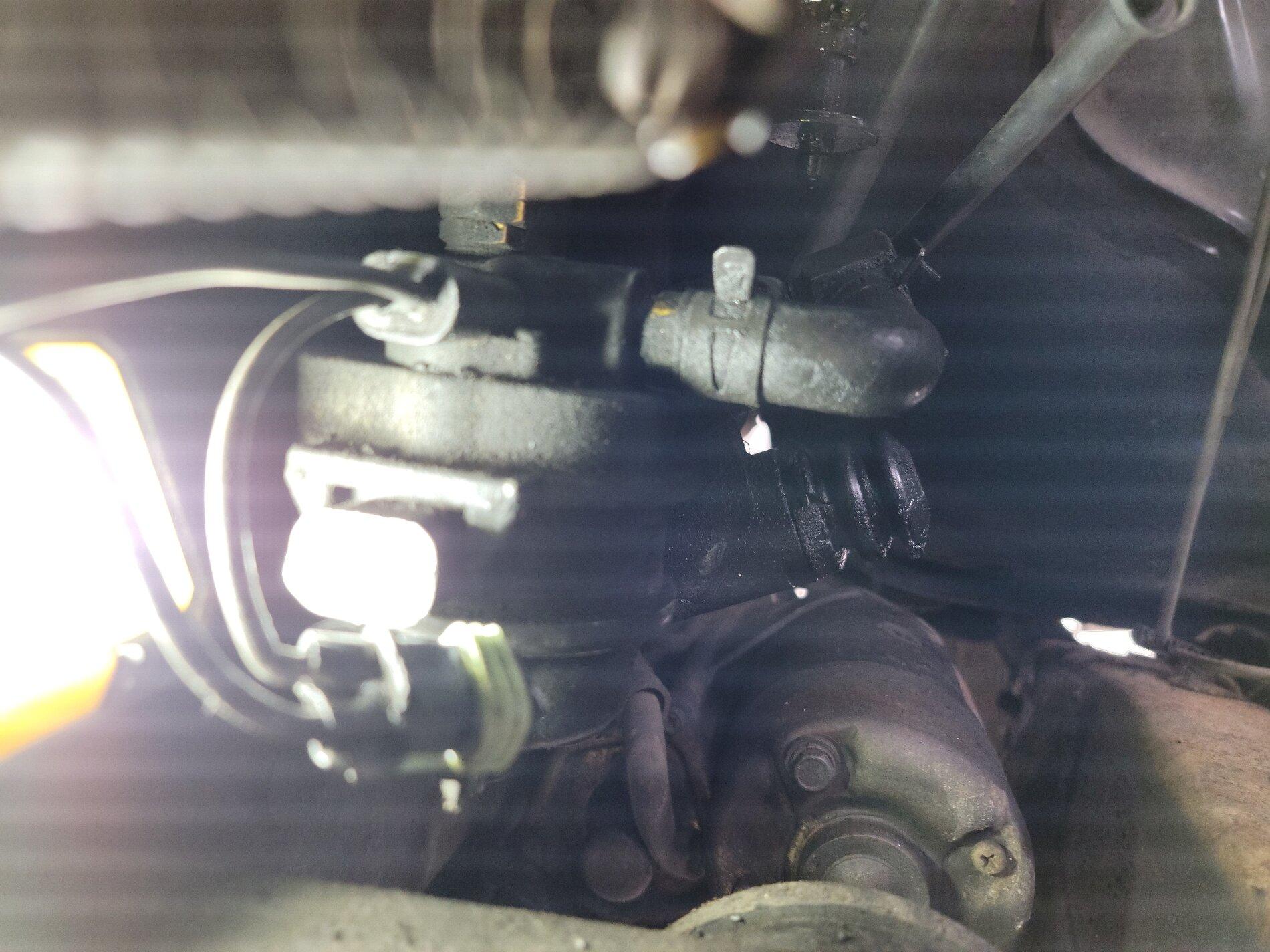

I have had the fuel heater plug melt on two different trucks and suck air through the plug. You can't see it melted until you unplug it. I filled the plug with silicone on one to get it home, and then removed the heater altogether once in the shop. The heater is not really ever needed. It about drove me crazy figuring this out, exact same symptoms yours has.

It is the electrical plug that goes into the heater itself. It is just above the lift pump and is part of the unit that you remove the screen to clean. The heater is a black plastic donut shaped piece that sandwiches between the screen and the bottom cap.
My truck was a 96 also and just died while driving just like what happened to you. The heater can be removed permanently, and you just put the cap on without the heater, but on the road I just put the silicone in the connection and left it unplugged. Truck ran great like that.
To remove the heater, first remove the bowl and the screen. Then you'll need an allen wrench to remove the adapter that holds the heater in. After removing the adapter and the heater, put the bowl and screen back on and you're done.
Plugging the fuel heater electrical connection with silicone worked! Truck fired up pretty rough, then smoothed out to normal idle. Drove it home, ran like a champ as usual.

I have deleted the heater deal, you need a Allen set for that, there is a small screw deal that unscrews then toss the heater, then screw back in the threaded deal and toss the cover back on.
