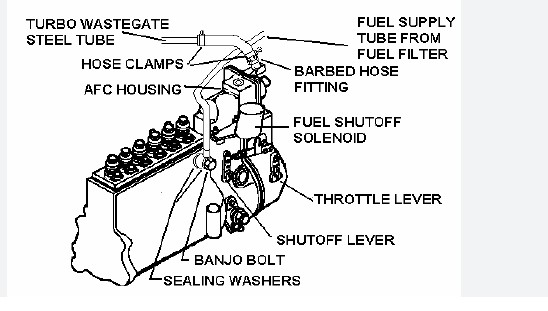

I've now realized that for the past 25 years of maintaining the truck I've not properly understood the function of the fuel solenoid. I had assumed that when not energized by ignition, no fuel could flow past the solenoid, as if the fuel solenoid operation was similar to the operation on my Yanmar marine engine, where pulling on a wire directly stops the flow of diesel, and the engine. I've now re-read Joe G's excellent article from 2008, in which he states:
"Fuel solenoid.
The fuel solenoid is actually not part of the fuel supply system. It pulls a lever on the side of the
injection pump. However, if there is a problem with it the symptoms are similar to problems with
the fuel supply system. Another thing to remember is that the fuel solenoid does not open or close
a valve. It parks the rack so that no fuel is sent to the injectors. Fuel will still flow through
the injection pump to the return line regardless of the fuel solenoid rod position."
The full article is at Joe G's fuel system writeup | Cummins Diesel Forum
Now I understand this, our next action to get fuel through the P7100 is simply to pull on the "fuel shut-off lever" on the driver's side of the P7100 pump, and manually operate the fuel lift pump to get some 911 fluid into the p7100 and through the injectors. I've attached a diagram for those like me who were unaware of the existence of the fuel shut-off lever.

The truck starts with the HP pump fuel lever pulled forward. With the lever in the shut-off position, the truck will not start and the solenoid will not fire. However, with the SS70a fuel relay shorted out, as shown in Larry B's excellent video, the solenoid fires and the truck starts, so a replacement relay is on order from Geno's. As Timd32 suggested, the truck will be serviced with all the fluids changed before the truck is delivered to the young lady in MD in the Spring.
