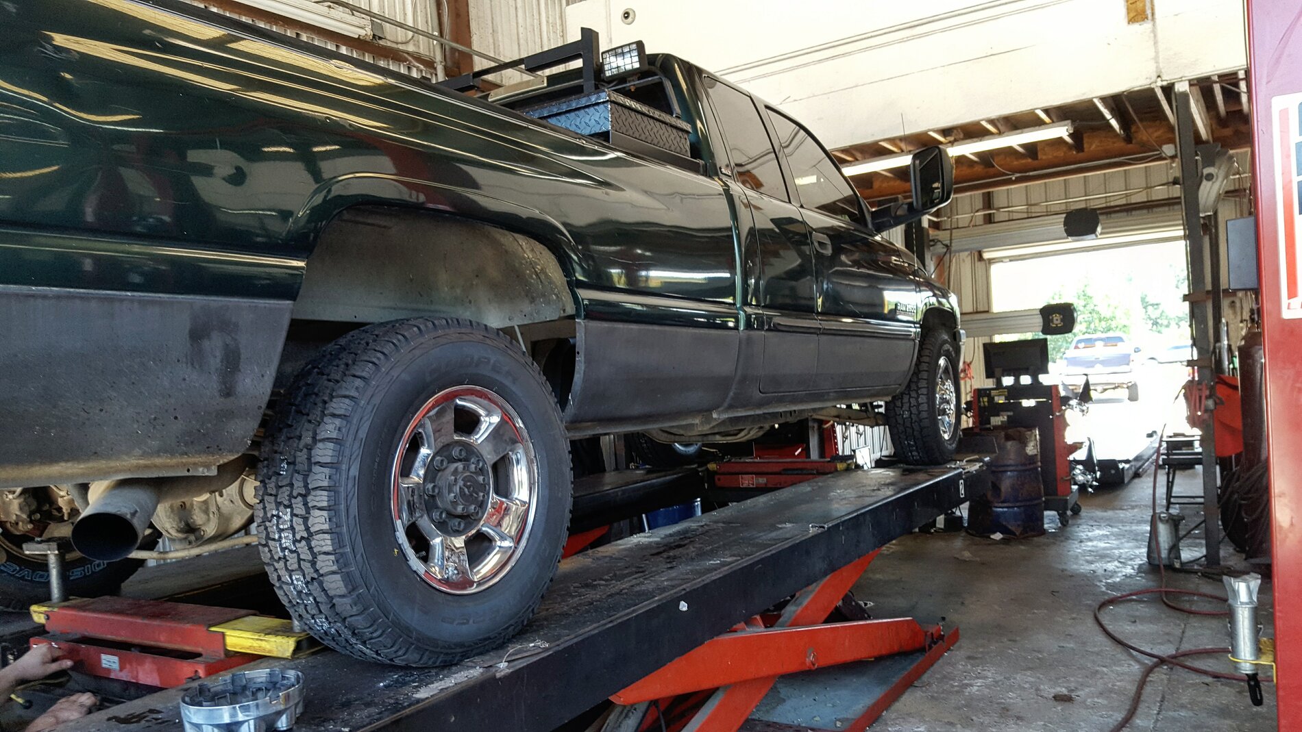

Update for now
Truck is being released by cummins.
cac is good
175hp to rear wheels
Turbo is good no shafty play
Fuel pressure holds at 25psi under load
Advance the timming by 15 degrees. ( does that mean put timing at 15 degrees?) Noted that after the timing advance it no longer has white smoke/ stutter issue.
Blow by is in spec at 2 inches. ( I dont understand that measurement. Feel free to explain)
shut off valve boot is missing. They wanted to replace that
Waste Gate bellows leak after it starts to open (Seems dumb of me to ask but would i notice this driving?)
So i have a new waste gate ready to go but they said the bolts were rusty and wanted to pull the turbo and if the bolts break ill need a new turbo. Rusty bolts on shut off and that could break and they would have to pull the p pump and have it sent off to be fixed. Total as long as none of that goes wrong $3300.00
The services ive had done so far make up 1,386.00 of that.
I said id take my chance replacing the acutator/ waste gate whatever you prefer to call it. Hope i dont mess that up.
