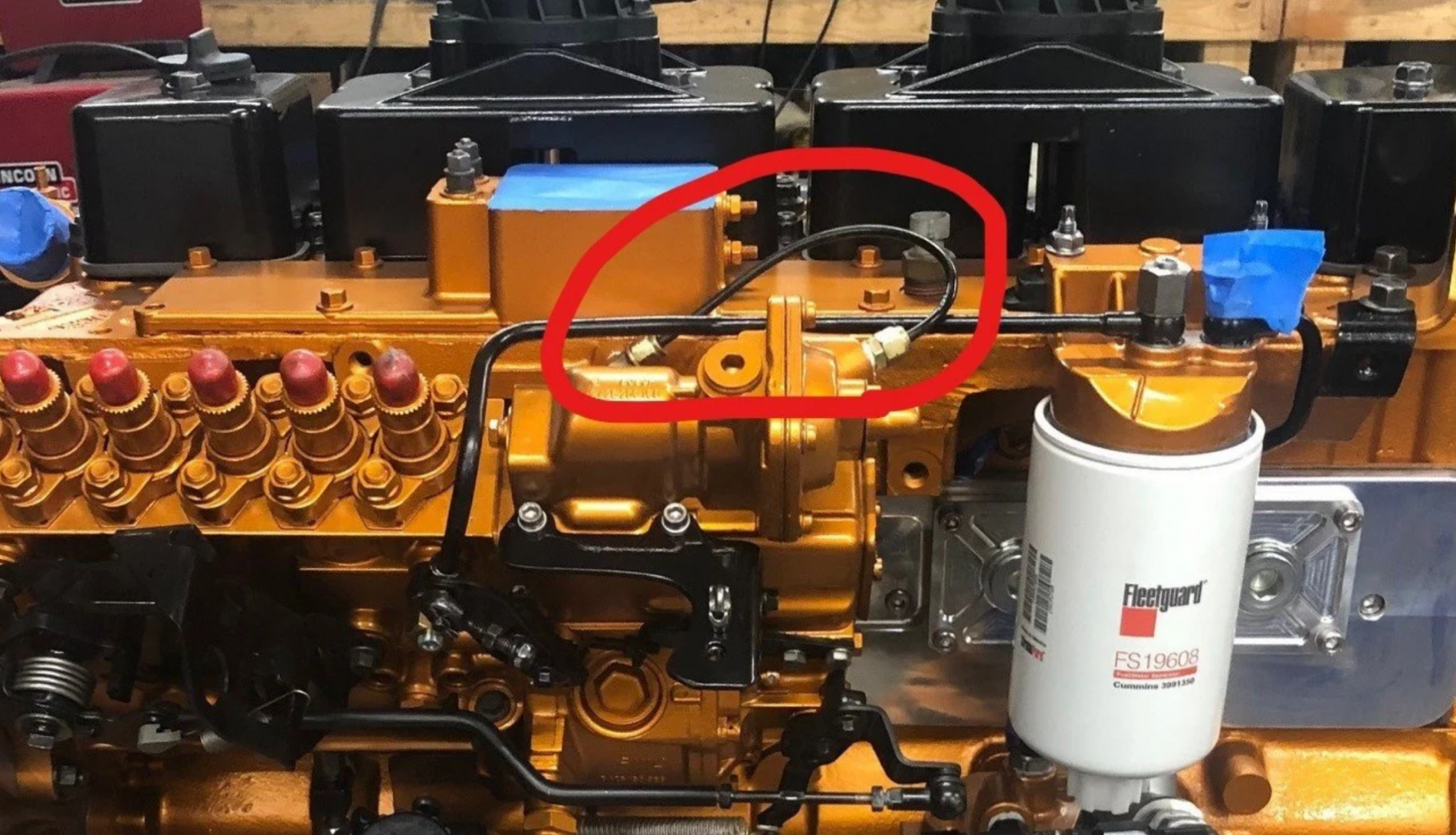

Can somebody tell me where the plastic line from the AFC goes? I have a shop manual on CD, if that will help. I have to put the truck back to stock. I know the plastic line from the intake manifold goes to the turbo waste gate (and my boost gauge) but I don't remember (put this in 5 years ago) where the other line to the AFC comes/goes. Right now it goes to the AFC live.
To the intake shelf on the head.
OK, that's right next to the line that goes to the turbo, so it must be manifold pressure too?
realistically, the Air Fuel Control measures boost pressure so any source that receives manifold pressure from would work.
If I remember correctly all the AFC does is slows down the rate of increase of fuel delivery based on boost pressure so the engine doesn't blow black smoke if you whack the throttle. It is basically a throttle delay so you dont get acceleration smoke, AFC tailors fuel delivery to the amount of boost. In other words the AFC is just a smoke control for acceleration so what happens with the throttle isn't immediately responded to at the injection pump.
