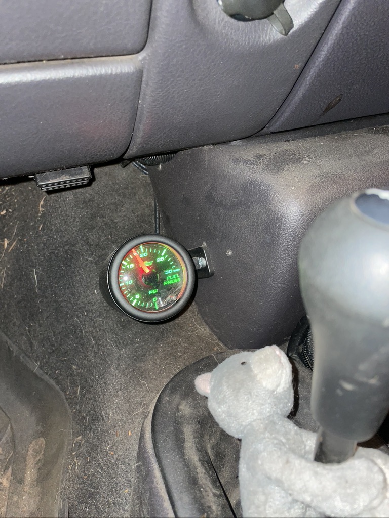

I had used Westach fuel pressure gauge for quite a few years. I had to replace three senders and one gauge. Of course I had to pay full price each time. This year just for fun I replaced it with a GlowShift gauge from Amazon for about half the price. Nine months and it is still is working. Time will tell.
Thanks for that input. I’ve gotten nowhere finding a replacement sender and saw the GlowShift option, more attractive price point. I’ve seen some dissing of these but I’m not up for spend the $200+ on the Isspro or Autometer electrics Geno’s has these days and I don’t want to go mechanical. My truck gets very light use.
How did you mount yours?
On plastic cover near floor
