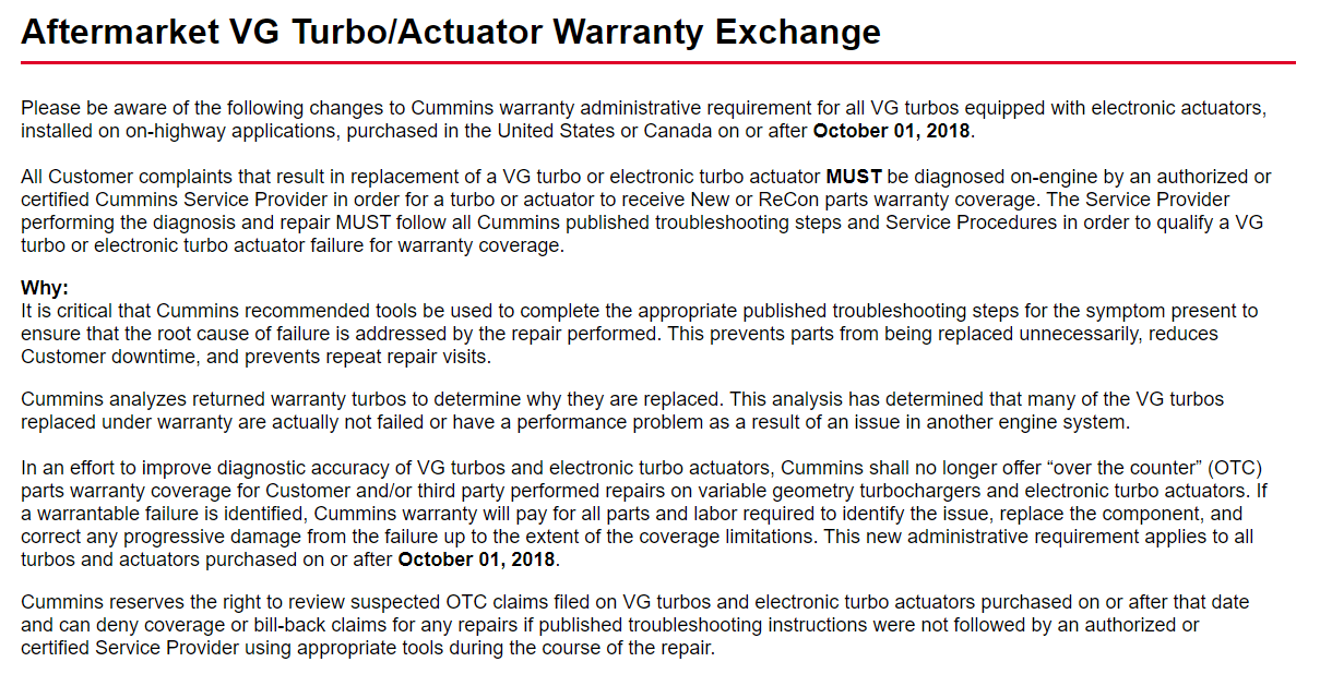

I have no idea what Ram's policy is on turbo and actuator warranty, but Cummins will only warranty a Turbo or Actuator if it was diagnosed and repaired at an authorized dealer.

Cummins gives no warranty to a Dodge or Ram truck. That was the deal arranged between Cummins and Dodge/Ram when they started putting Cummins engines in our trucks.
I just posted Cummins policy to let you know that even Cummins won't warranty a Turbo or Actuator, much less reimburse you, unless it is diagnosed and repaired by an authorized Cummins repair facility.
