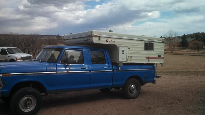

Quick update to folks - Fordge is running nice, and is my daily driver. A few changes - I put an MTS 33 gallon fuel tank in it, with a new sender and pickup. The old 19 gallon MTS tank didn't give me the range I wanted. I have to keep the spare in the bed, but so far not too annoying, and my range is about 30gallons x 17. 8mpg on the last tank, so 530+ miles each fillup. It is showing 14. 8K on it now, work is only 10 miles down the road, and I ride a bike or motorcycle when the weather gets nice, so slowly piling some miles on.
