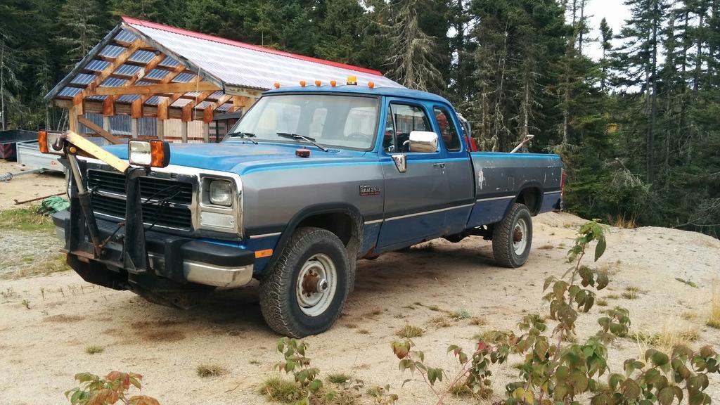

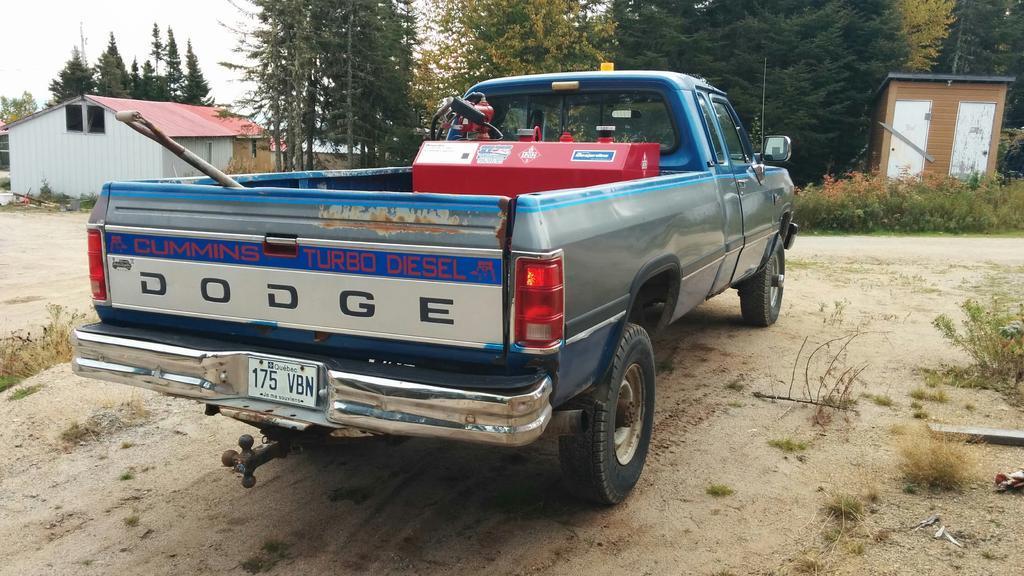

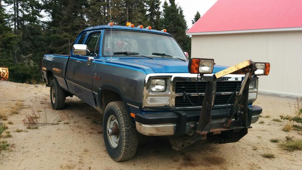

I`m from Québec , bought a 1993 cummins powered LE club cab W250 with 153,00 kilos ( 98,000 milles ») with a freshly rebuilt A518 and brand new rad .....
never been painted , but front cab bushings are shut and floor pan is quite rusted ....
Autobody specialist has all the body parts I need ..

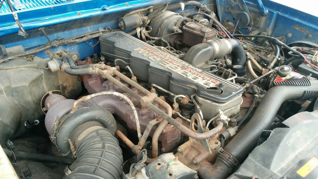

already modyfied the VE pump , installed the boost, EGT, transmission oïl temp gauge .....
next move will be 5 x .012 nozzles , HX35W turbo ,4 inches exhaust and better CAI .....transmission better Oil cooler too ....
