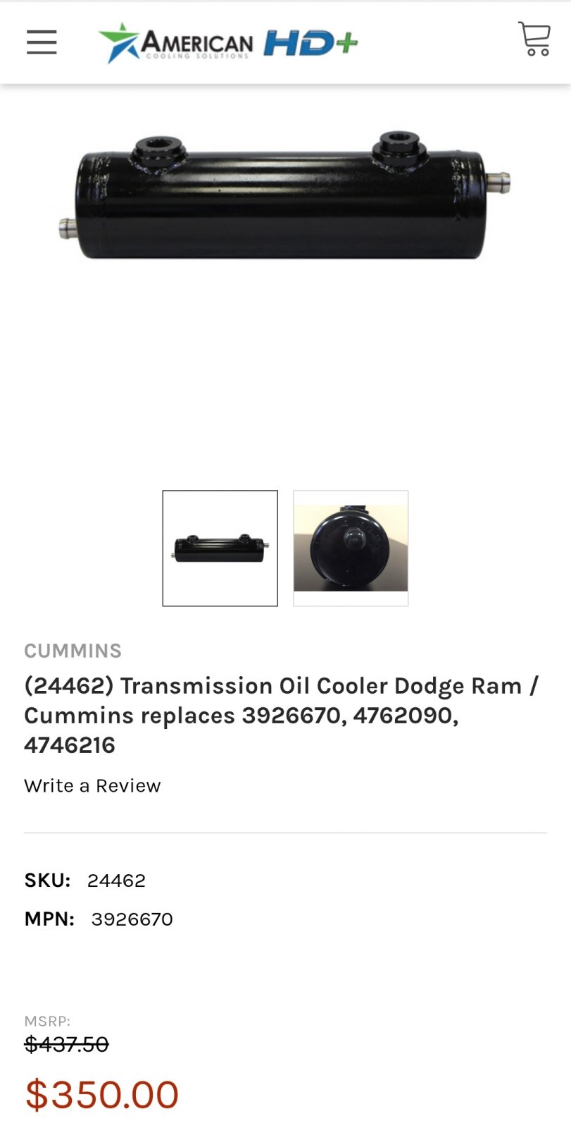

This is where I got mine, still shows up this many years later.
https://www.americancoolingsolution...ram-cummins-replaces-3926670-4762090-4746216/
