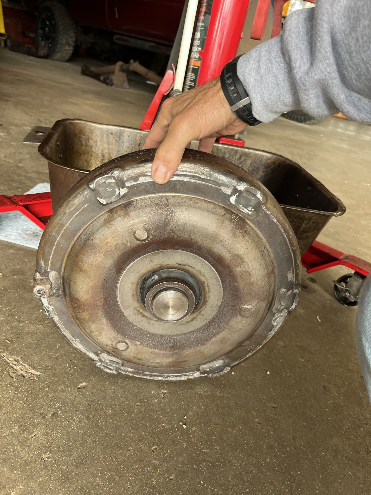

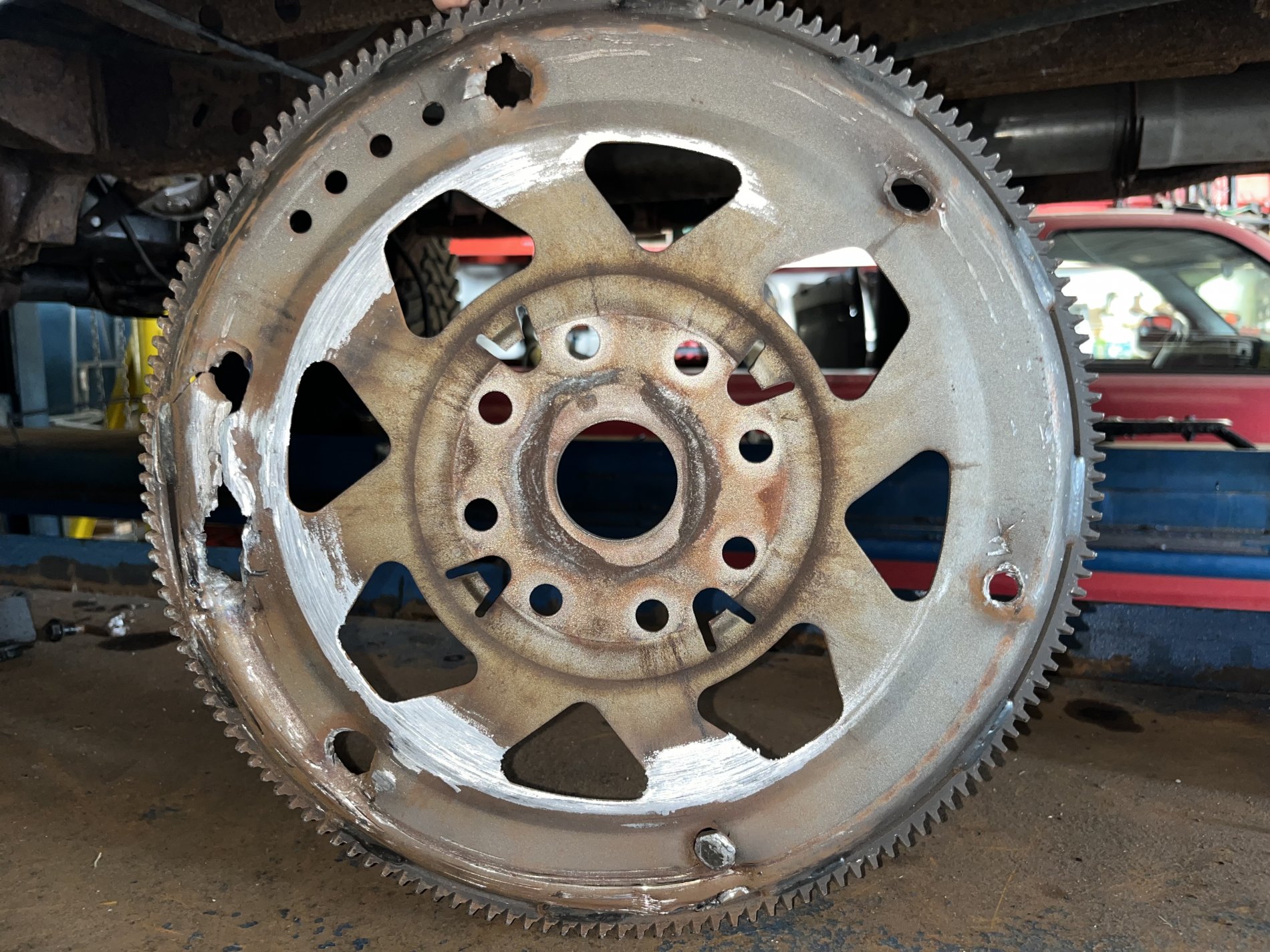

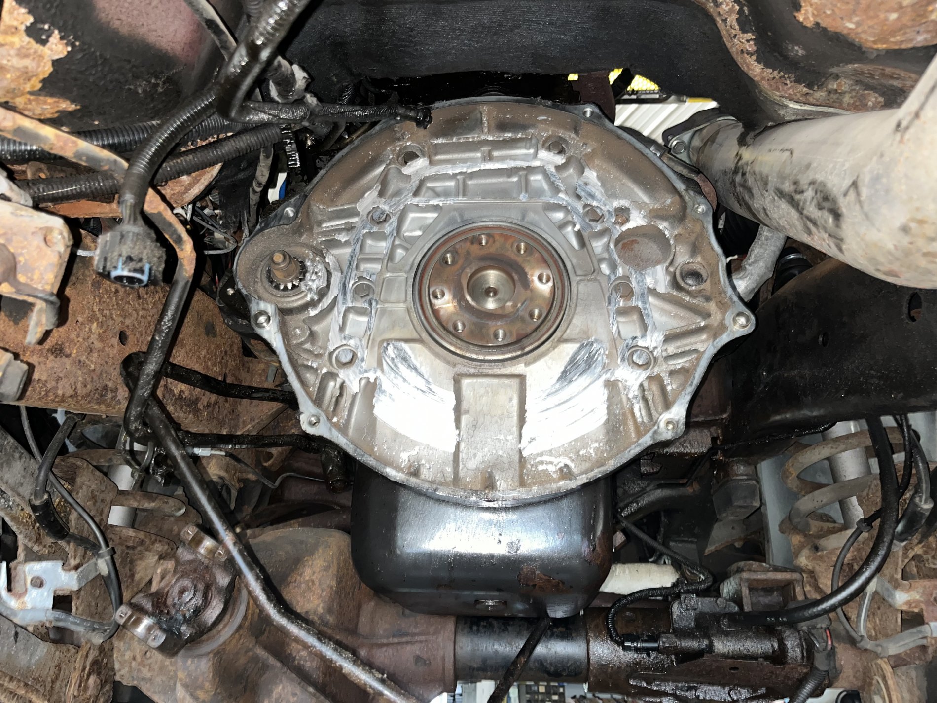

Happy Sunday! Trans is out. Bad flexplate, torque convertor, starter bendix, and broke a trans line on removal. Mechanic told me that it's not worth repairing. He won't put it back together or put in new parts. Says I'd be upside down in it. So, I'm questioning the future of this truck. Can I get a cheap flexplate and starter to be able to start the engine for someone to hear it run? I'll upload pictures of damage after church for you gents to view.

Mechanic also said that the housing between engine and trans should be replaced.

So, you need a flex plate, adapter plate, a TC, and a starter. Sounds like the tech owes you a transmission line. What year is your truck? You could source a flex plate, TC, and starter for @ $1,000 from Rockauto. Adapter plates are available used. If labor was $1,000, you couldn’t replace the truck for $2,000.
There’s really no reason there’s any more damage.

The weak point of these tranmission turned out to be the low quality TC and low line pressure for the RPM ranges of the Cummins.
A mildly upgraded TC will do wonders. Have him throw it back in, then if you're a little mechanical, slap a shift kit in it to boost the line pressure, a GM style solenoid, and mechanical shift solenoid spring. You'll be good for another 70k.
