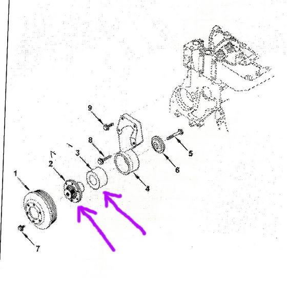

Got it all apart but whoever replaced the fan clutch last ,cross threaded the hub to to fan clutch stud.

Interesting to work on a system that is 1/2 Cummins & 1/2 Dodge & have to deal with 2 separate entities to complete a seemingly simple job.
Turns out the stripped hub & bearing are Cummins Factory only parts. Both local Dodge dealers quoted a 14 day delivery time on the hub & bearing if they "special" ordered it.
Called Inland Kenworth & they were able to locate both parts directly from the Cummins factory.
The factory was nice enough to offer overnight shipping but on Friday afternoon... that means Monday.
You can get the Cummins parts from Mopar but they are a lot more money so I always point folks in the direction of Cummins when possible. That bearing is available from Motion Industries for a lot less money. I am on an I-pad right now away from home and my notes. The part number is on here somewhere from a few years back, Cerb and I went through this. His instructions for pressing it apart and reassembling are in here as we'll. I can try to search those two posts up later on tonight if you can't find them.
Mike.
I was in a tough spot & just went ahead & ordered both parts from the Cummins factory.
Fan hub is Cummins part # 3911661 $137. 00
Bearing is Cummins part # 3910739 $119. 00
We already have the bearing removed & it looks like a pretty straight forward install.
