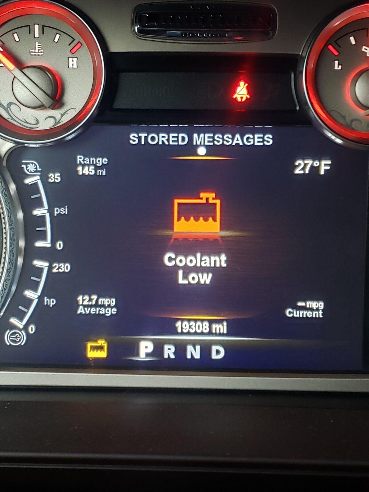

19k miles and low coolant message pops up.........

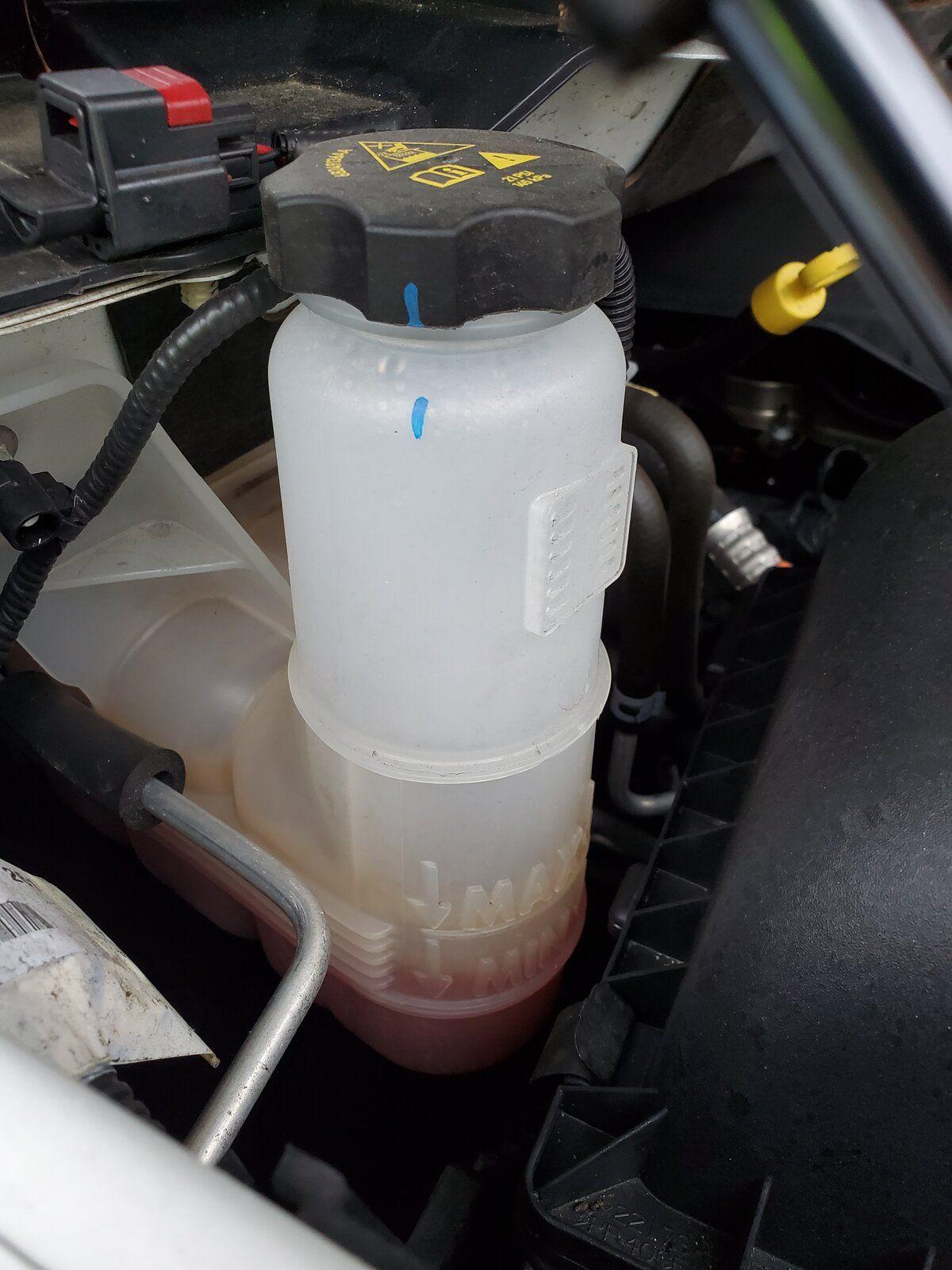

My 17 did the same thing somewhere around 30k miles cant remember if it was summer or winter but thinking it was summer time. I had to add some, wasn't too much hasn't happened again since except when they did the water pump recall somewhere around 50 or 60k then I had to add some more the next day but again not since then now at over 100k miles.
I'm the bad guy, i always overfill the bottle and let it level in by itself. To much fluid, off it goes.:D
After a couple good heat and cool cycles the level stays where it wants to stay.
Closely monitor coolant loss.
Suspect part : EGR cooler leak. It is of no concern to performance as the coolant is burned/evaporated instantly. So a slow trickle eventually leads to low coolant level and, if you don't watch the idiot light or notice a high (remaining) water temperature, you would overheat an engine.
