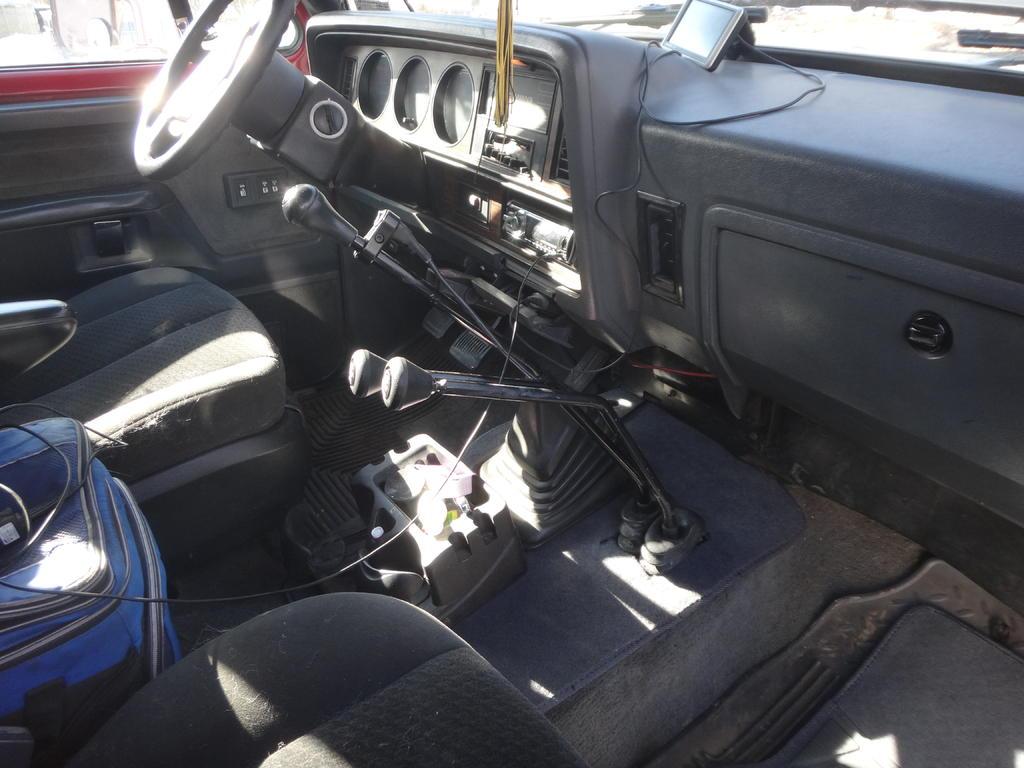

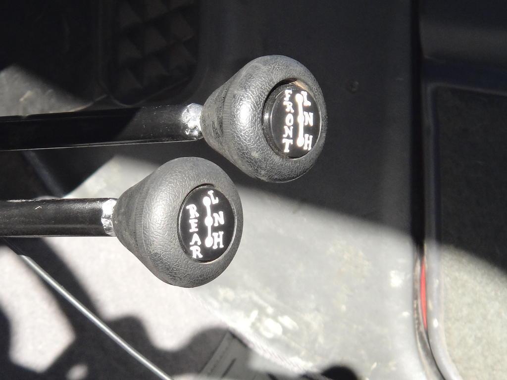

This is what I mean by twin stick conversion, I wont give you all wheel drive like a 203 but it will give you more control of the 205, My truck handles well in the snow when its in 4wd you just have to slow down a little.

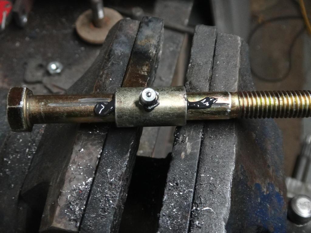

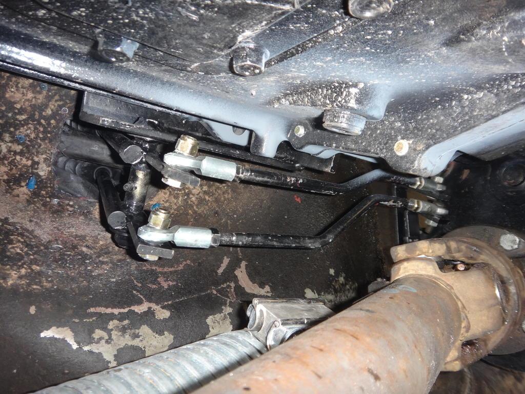

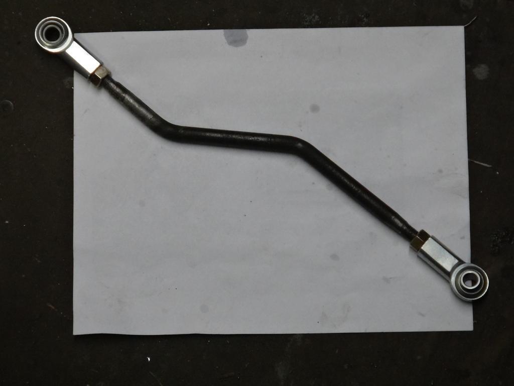

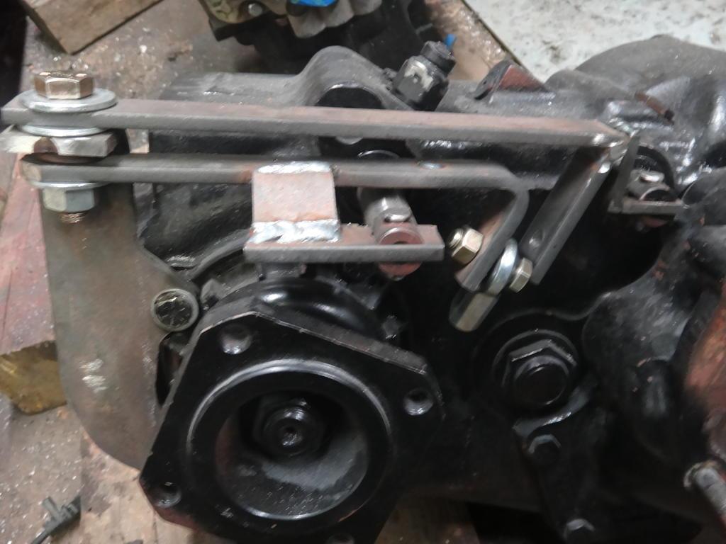

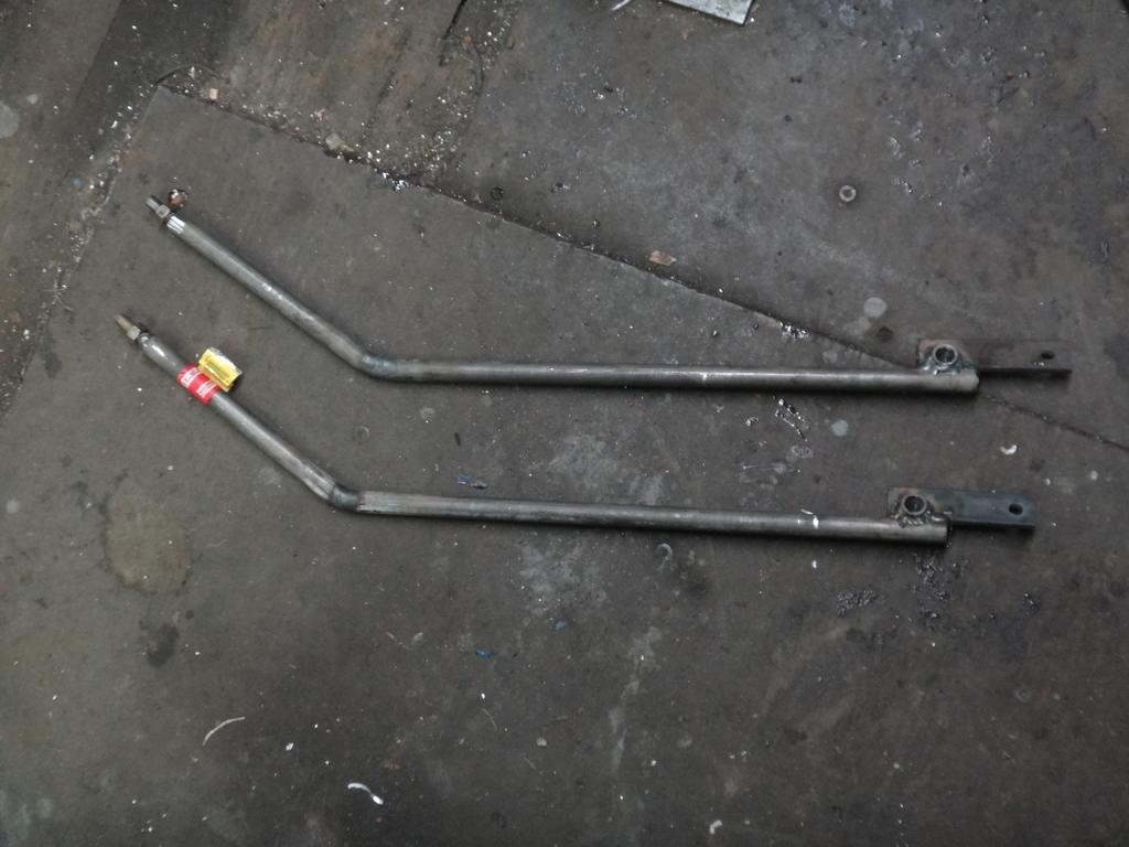

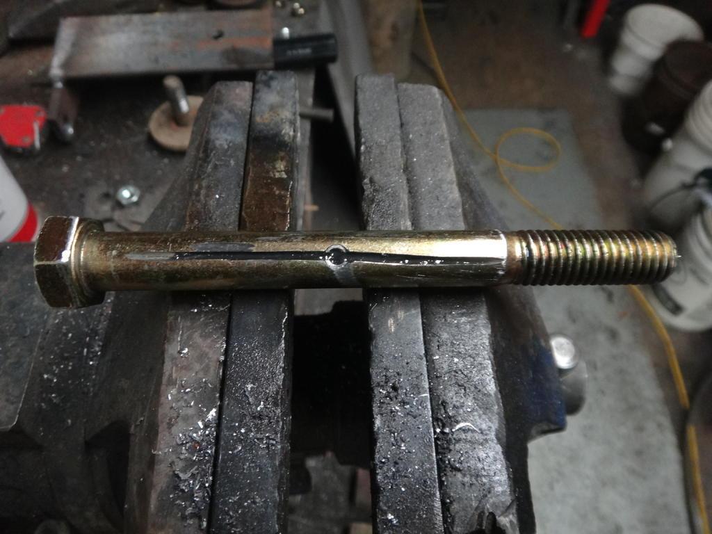

I used a 1/2" grade 8 bolt for the lever pivot and cut a grove in it for greasing the shaft, welded it to peace of angle iron that mounts to the transmission. I use 3/8" round stock with hiem joints on the ends for the linkage between the lever and case and 1/4" by 1" flat steel for the pivot arms that connect the linkage rods to the internal **** rails
the shifters move the linkage witch move the pivot arms witch move the shift rails, the pivot arms may seem redundant but they give more leverage on the shift rails and make it easier to get linkage on the inner rail.
You don't need special shift rails, but I do have the shift rails from off road design that allows me to have front wheel drive only along with several other configurations
