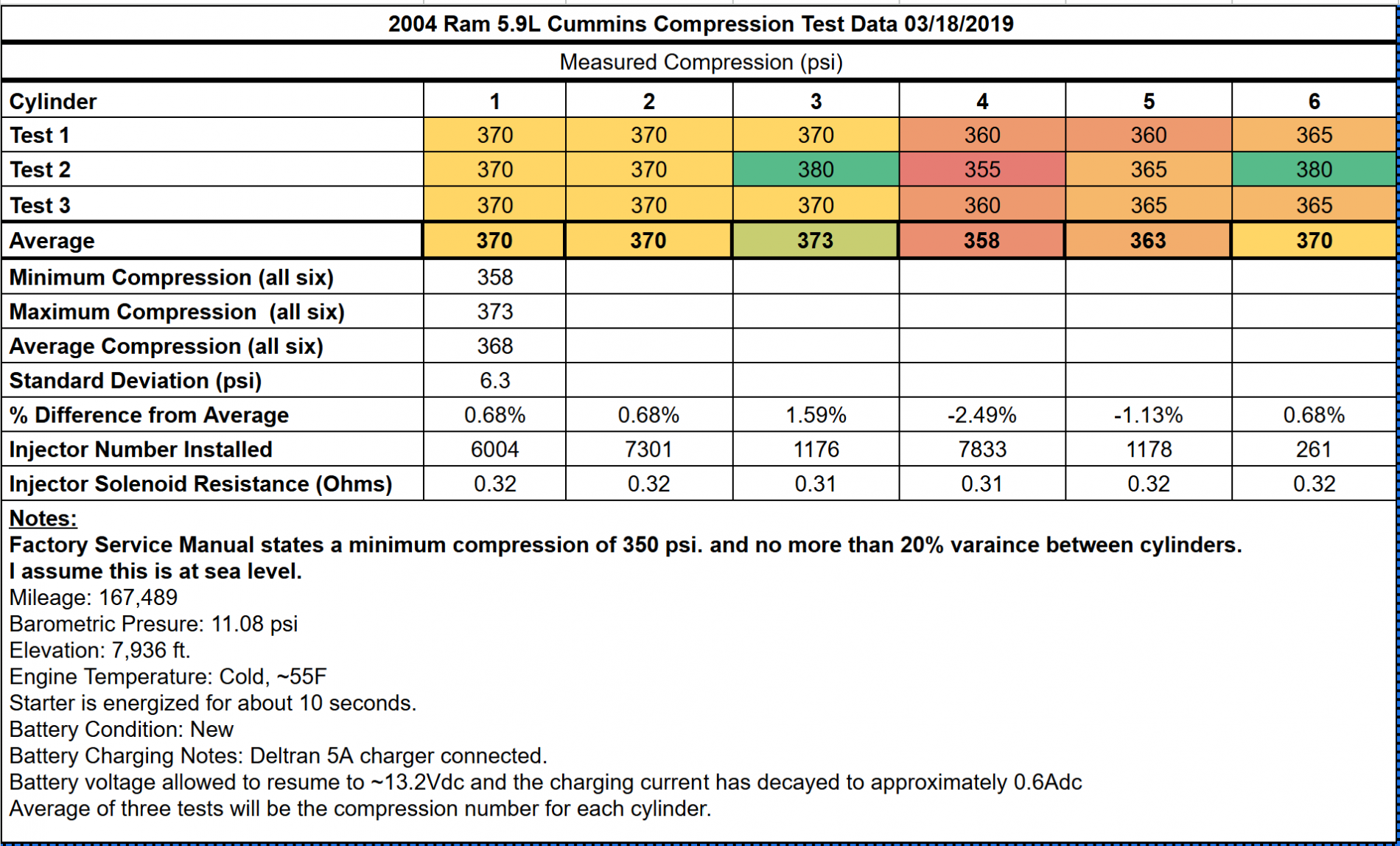

Hey all,
Haven't posted in a long time. I was going through some of my data and I thought I'd post some numbers for my compression test that I performed in 2019 (when I installed new injectors). This information is mainly for reference and includes a lot of parameters that I thought would be useful for the readers. Enjoy. Post some comments if ya like! Let me know if I did anything wrong or what could be improved. I believe these are good results, note my elevation listed in the notes below.
looks good to me.
when I saw the baro pressure my first thought was how far off it was from atmospheric
my second thought was darn near 8000 feet explains that and the lower compression reading than I expected.
