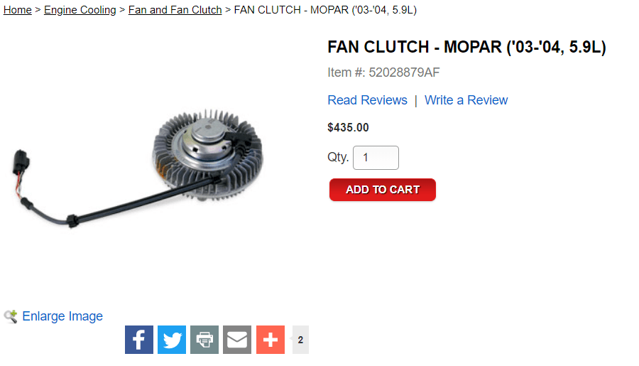

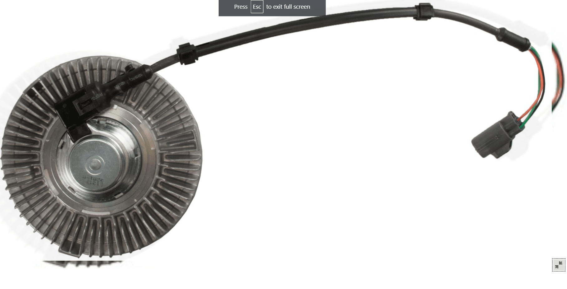

This is the one I put on my 04 (305/555) engine when the original failed, Call Genos, they still show it online.
https://www.genosgarage.com/product/52028879af/fan-clutch

So with this fan clutch for example. If the clutch was $195 or $435... what would your choice be? I chose the NAPA one, free shipping and I had a 20% off coupon.
