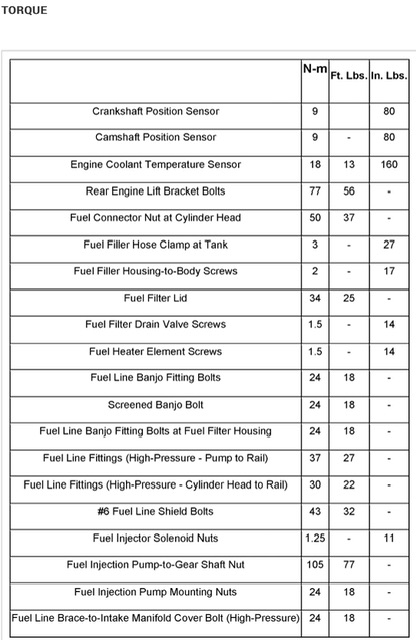

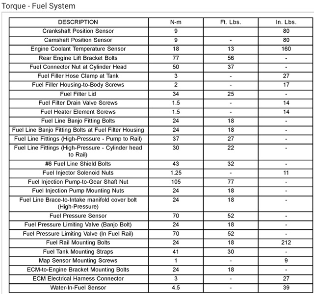

@Ozymandias the FSM says 37 ft lbs for the connector tube nut. Are you saying its 47 ft lbs? I'm more than likely getting some BBI 0.5's when the weather cools in Texas. Getting all my ducks in a row so to speak.
From AllData
7. Tightening Sequence:
a. Install fuel injector holdown clamp (mounting flange) bolts. Be sure the clamp is perpendicular to the injector body. Do a preliminary tightening of these bolts to 5 N·m (44 in. lbs.) torque. This preliminary tightening insures the fuel injector is seated and centered.
b. After tightening, relieve bolt torque, but leave both bolts threaded in place.
c. Install high-pressure connector and retaining nut. Do a preliminary tightening to 15 N·m (11 ft. lbs.) torque.
d. Alternately tighten injector holdown bolts to 10 N·m (89 in. lbs.) torque.
e. Do a final tightening of the high-pressure connector and retaining nut. Tighten to 50 N·m (37 ft. lbs.) torque.
8. Install integrated gasket
9. Connect injector solenoid wires and nuts to top of injectors . Tighten connector nuts to 1.25 N·m (11 in. lbs.) torque. Be very careful not to overtighten these nuts as damage to fuel injector will occur.
10. Install exhaust rocker arm assembly. Refer to the Diesel Engine section.
11. Set exhaust valve lash. Refer to the Diesel Engine section.
12. Install fuel connector tube nut at cylinder head and tighten to 50 N·m (37 ft. lbs.). Be sure to use a secondary back-up wrench on the connector nut (fitting) while torquing fuel line fitting. Refer to Fuel Line Installation for additional information.
