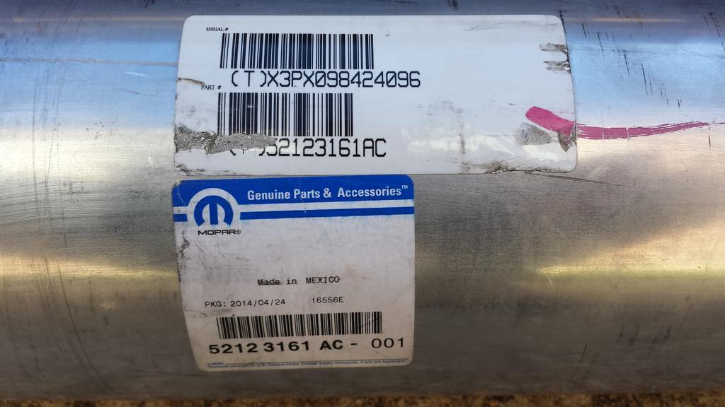

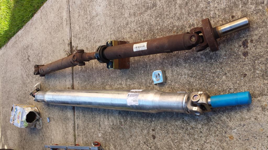

Just wanted to come on here and tell everyone about my drive shaft swap. My truck has 119K miles and it's a 06 Mega Cab, 3500 SRW, 4x4, 5.9L Cummins w/ Automatic (48re). I've gone through 3 carrier bearings in the last year and a half after I did a 6" lift and 35" tires. OEM PN 521231161 AC was a bolt in replacement for the 2 piece shaft. The swap tool less than 10 minutes and half of that was spent taking off the carrier bearing bracket. Only time will tell if this was all worth it but for now, I've had the new drive shaft on the truck for 3 weeks and drove it on a 4 hour road trip plus it's my daily driver and it is a noticeable improvement.
Additional comments: Although I can't say that I'm seeing better MPG, I can say that the new drive shaft is less than half the weight of the steel 2 piece. Also, I can't find any reason why I needed the damper so I bought this one because it comes without one.
I have the exact same DS installed in my truck (after shortening 1.5" and balancing). Great improvement - almost zero launch shudder unless I really mash it.
