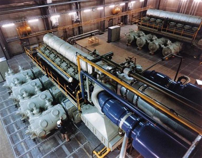

I know the 6. 7 is what I'll call a "reverse flow" engine. By that I mean the exhaust is in the valley where the turbos are, and the intake is where the exhaust usually is on "V" config. The valve covers actually act as a manifold and funnel the air into the head. It's unconventional to say the least.
Center exhaust configurations are conventional for large industrial V-design engines. This simplifies exhaust manifold and turbocharger designs. Here's an example of such an engine.
The two turbochargers are in the foreground with their air-to-water intercoolers directly beneath them. The turbos are fed by the thermal blanketed constant pressure exhaust manifold centered between the banks of the V, and the turbos exhaust into the large insulated pipe that's centered between the two blue air intake pipes feeding the 24" turbocharger compressor impellers.
