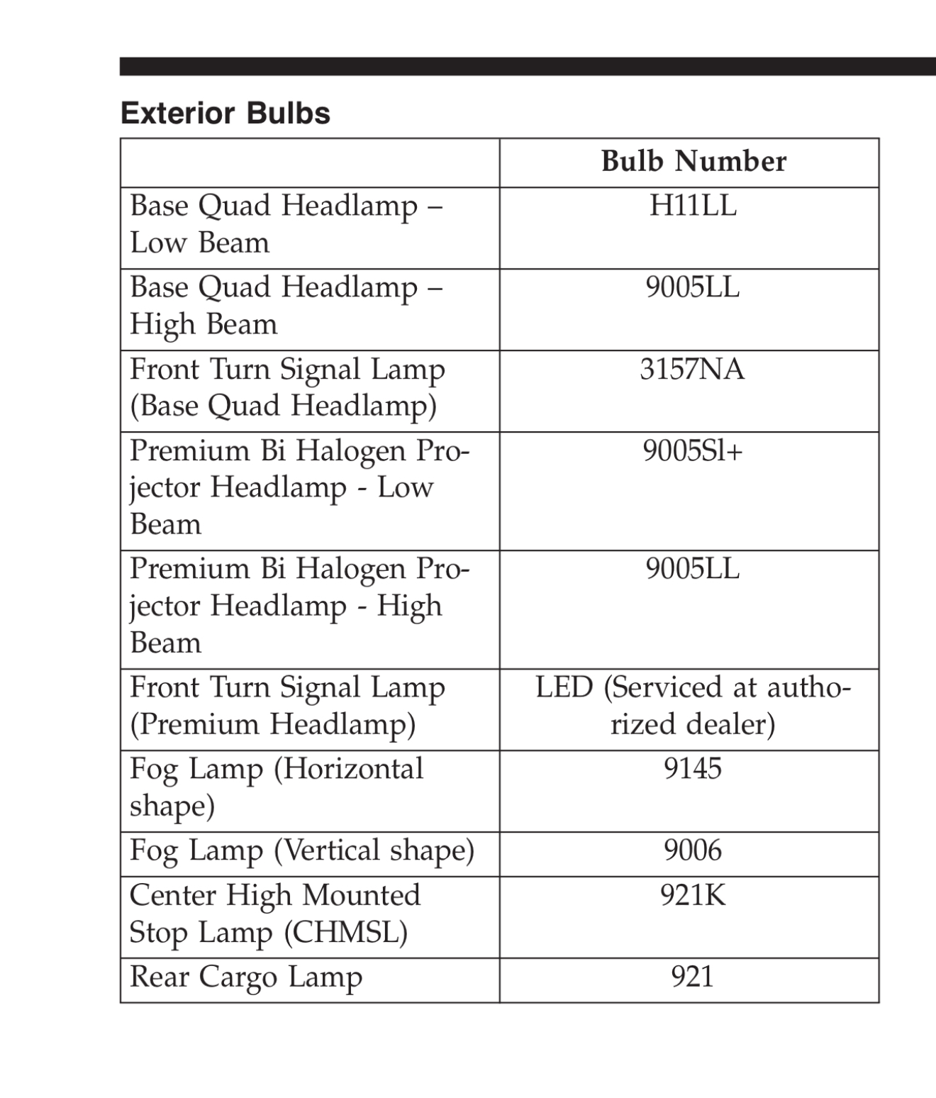

What year is your truck?
From my 2018’s manual.
