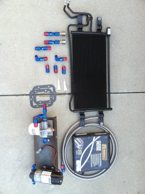

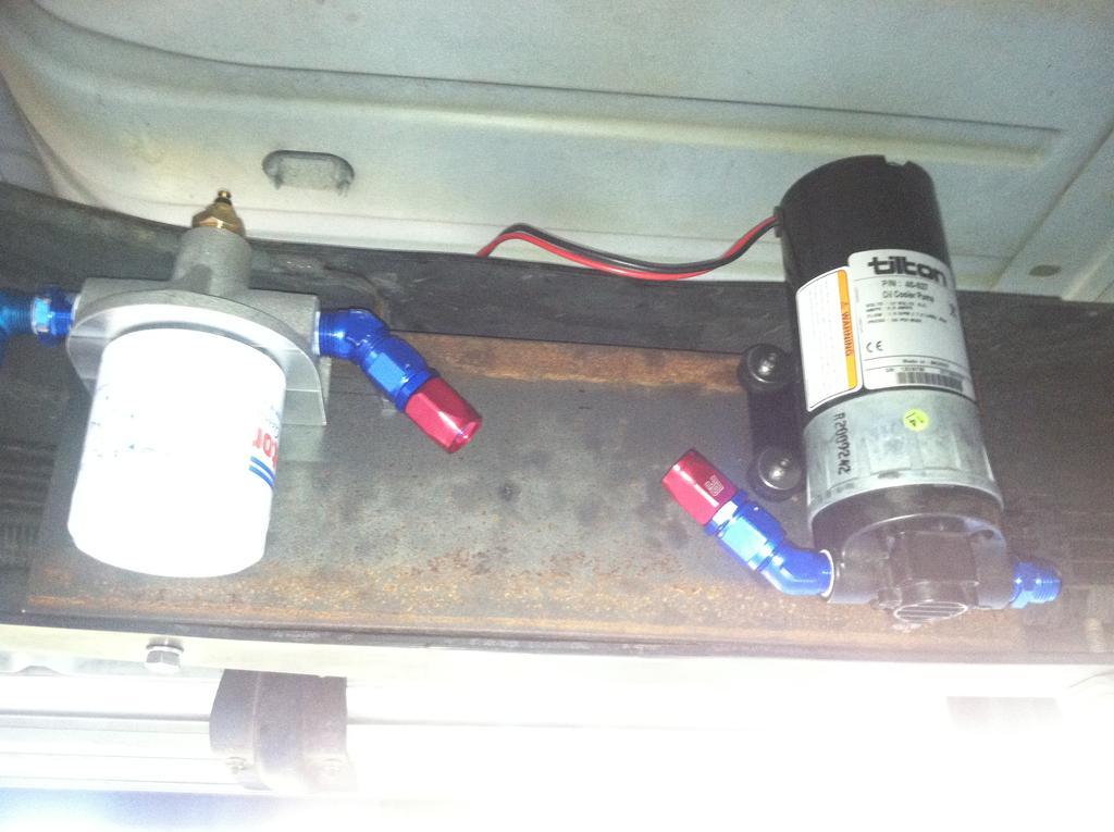

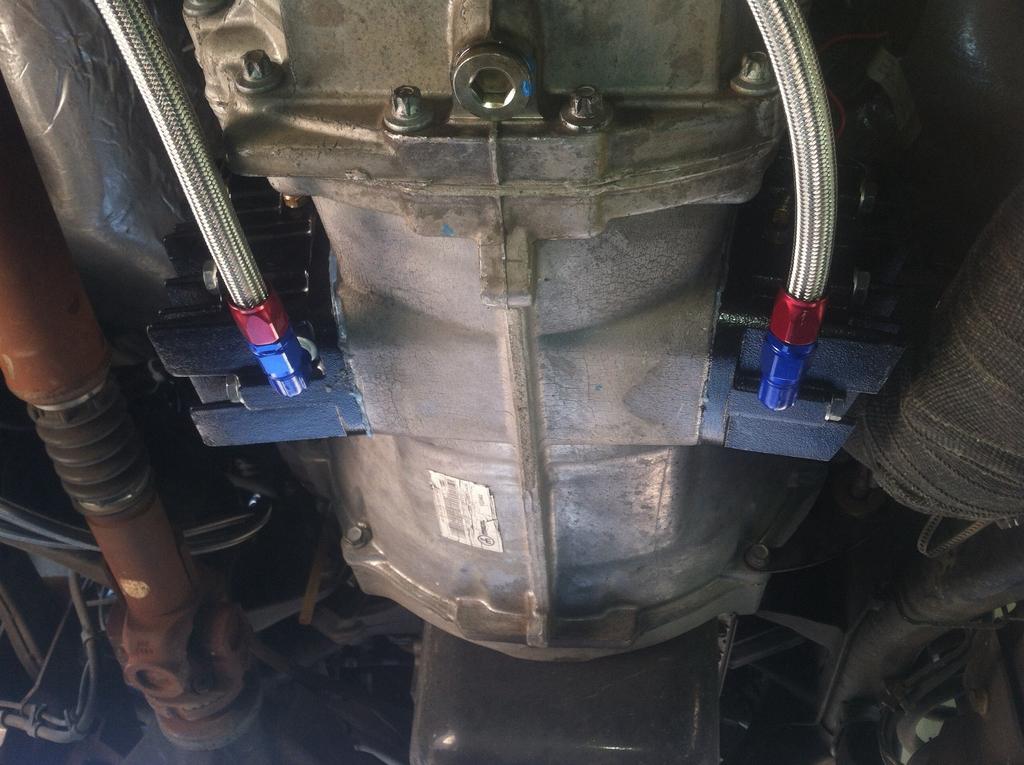

The coolers from Geno's really didn't work on my G56, and once I installed temperature sensors, I saw up to 250* temperatures. Anyone with a G56 should consider my cooling system that I developed for mine, and I now keep my trans temps at @ 175*, even at 23K combined weight.

Might attempt that after my 7 year warranty is up. Is the filter necessary because of the pump?
Are those Geno's coolers on the side? Was there a plug to remove or did you tap them for your sump and return?

250*+ Is the kind of temps I used to see in my ZF-S5 in an F-350 using overdrive. Did your G56 get than hot only in overdrive, or in direct as well? With ATF, or all/other oils?
I love the idea of only 175* @ 23k GCW.
Your setup looks good.
Might attempt that after my 7 year warranty is up. Is the filter necessary because of the pump? Yes
Are those Geno's coolers on the side? Yes Was there a plug to remove or did you tap them for your sump and return? I drilled and tapped them.
250*+ Is the kind of temps I used to see in my ZF-S5 in an F-350 using overdrive. Did your G56 get than hot only in overdrive, or in direct as well? With ATF, or all/other oils? Both, but that was only at 15K GCW with the boat in my signature.
look for the answers in the quotes.
Because the oil cooler is located behind the inter cooler, it can cause the oil temp to rise across the cooler from high boost pressures/temperatures when climbing grades at 23K, so I shut it down until the boost drops off. That's an unexpected consequence, and if it had been a 4th gen truck, I would have used BD performance's oil cooler, in link provided.
