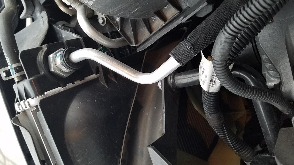

My 2015 has a cooler inside the radiator followed by the air to oil cooler.
Edit: dang photo rotating board software! :)
