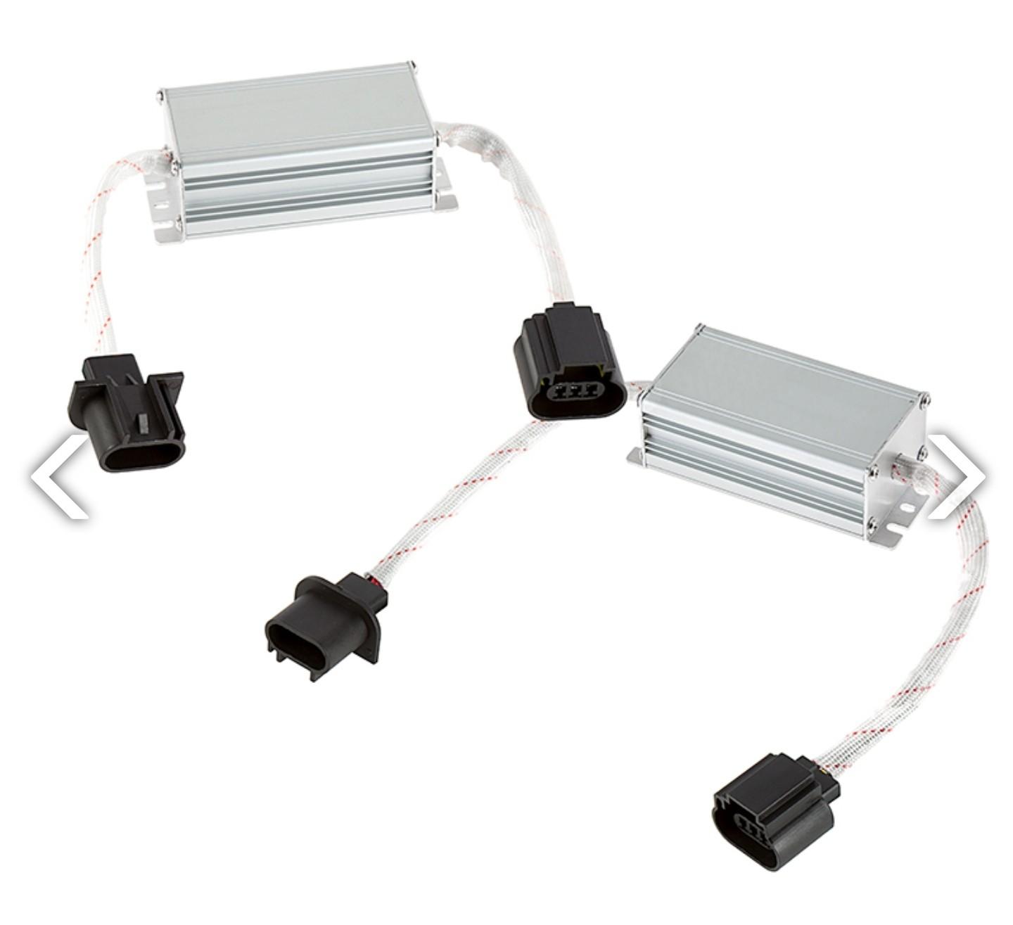

LEDs you either need to enable the sales code or use resisters to get the light out messages to stop and to get a normal speed turn flash. The LEDs had nothing to do with the 4wd shift issue.
Earl
Yeah dont get too down on your self just need a little resistor to balance the circuit. Sounds like a fun project.
Look up LED resistor.
They can get hot, you can watch some videos of them on YouTube.
