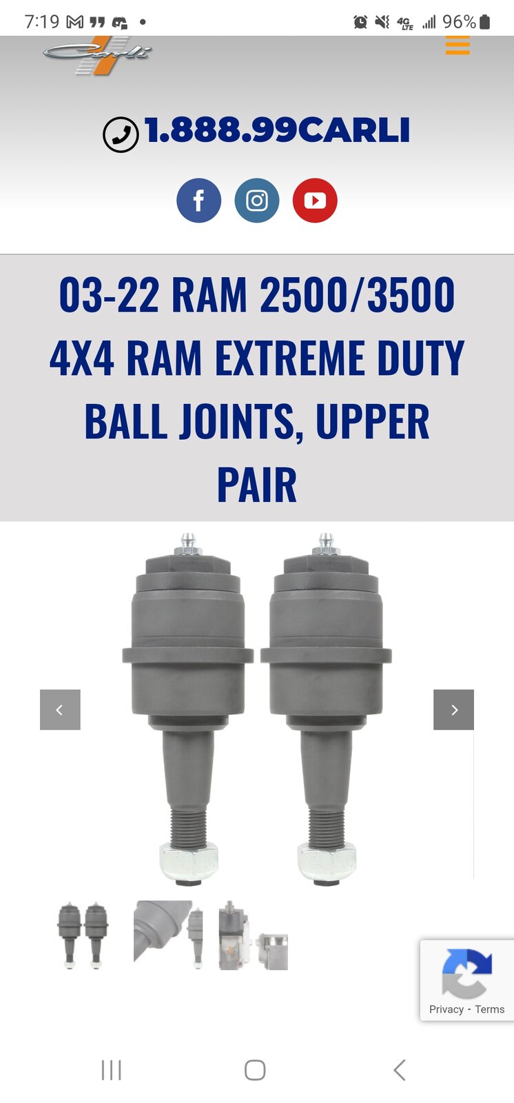

2018 Ram 3500 6.7l diesel cummins 4x4 non-dually , about to change front upper ball joints. per wheel alignment tech, "upper ball joints are worn." Truck is at 75,000 miles. I'm about to install ~$500.00 carli upper ball joints from Carli Suspension.
Anyone have any experience with this brand? I hear people are getting 100,000 plus mileage on their carli ball joints. I do a lot of gravel road driving/towing with occasional pot holes here and there. Therefore, I might get only 70,000 mileage before I have to change again. Thanks

I would have to agree that since you have all the labor involved to get the top ball joints replaced I would also replace the lower joints.
Several years ago I put the Carli joints in my truck and while they are expensive I would buy them again.
